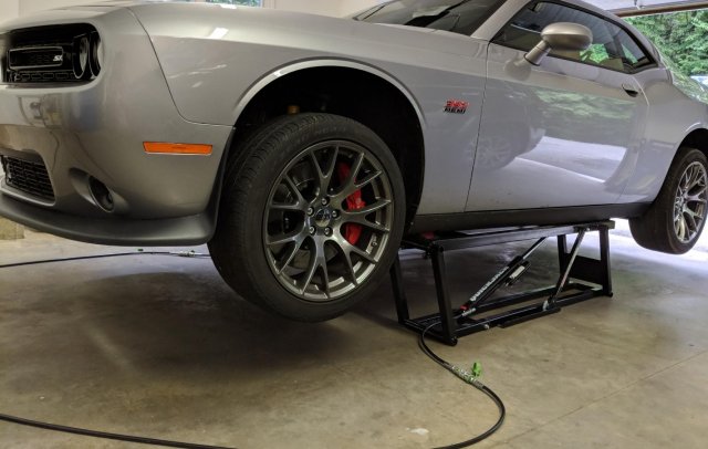

had to google quick jack, now I know :) seen them before never used one before. looks like a sore back jack to me.
Octanewide
#988
967
1,801
House of power
