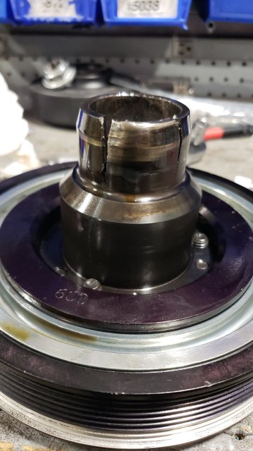

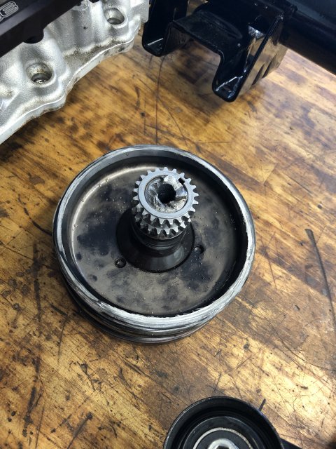

My son has a built 433 hemi in 22533.jpeg 22537.jpeg his jeep grand Cherokee. It's all forged and is pro charged.

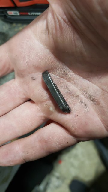

He's having a problem with the crank damper cracking along the keyway slot. This is the 2nd one since spring. Its an ATI damper. What could be causing this? 22502.jpeg 22501.jpeg 22503.jpeg

Consulted my brother the engine-nerd and here are his thoughts:
ATI hub will be hardened and that is a thin wall. Looks like fatigue failure. I hear they pin the balancer to add a second key way.

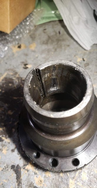

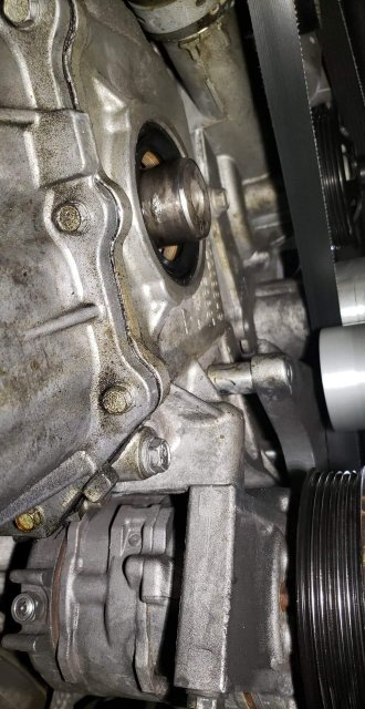

Replaced the damper today. Son ran it about 1/2 mile and the damper broke.

How did the keyway measure up to the actual key? How did the dampner install? Tight with quite bit of force going together? Or go together loose? I am picturing an issue with the key and keyway relationship.

Without seeing the installed setup, I’d say there is a massive belt alignment/tension issue with that procharger.
That happened within 1/2 mile? Something is yanking on that damper wrong.

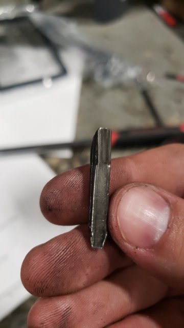

The original key was too distorted to get an accurate measurement.
My son installed the damper so can't speak to how tight it was. But I think it was snug

It looks to me like your key is too tall. What method is your son using to install the damper and how much force is it taking?

As I thought about it, I feel the key is either too tall too wide or both.
