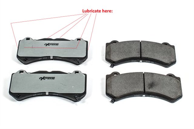

I put the Power Stop Z26 pads on last year. I have been out a couple times this year and have noticed the pads squealing. Usually worse backing out while the brakes are cold. It seems to go away once the brakes are warn. Does anyone have a way to stop this? I did use some of the Permatex break quiet on the pads before installing them. I also followed the recommended break in period last year.
All you need to do to stop the brake squeal is remove the pads, whiz off the paint per the pic, lube with a high-temp silicone brake lube and reinstall. You do not need any other "Anti-Squeal" stuff.

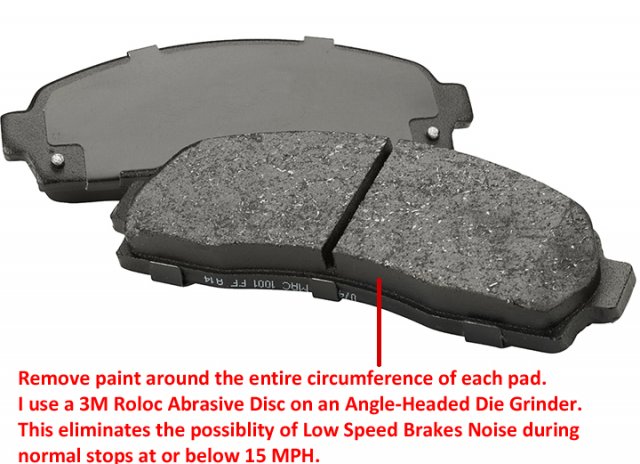

Here is the Technical Explanation why the paint should be removed from the sides of Friction Pucks:
Brake heat softens the paint and it balls up, rolls onto the brake pad. The sticky, soft paint causes the brake pad to "chatter" on the rotor instead of sliding. We hear that "chatter" as a high frequency brake noise. Most of the time, this noise usually occurs at or near the end of a normal stop at or below 15 MPH. Increasing brake pedal pressure may help attenuate the brake noise which can be a diagnosis confirmation of this issue. To prevent any and all of this brake noise, just whiz the paint off the friction puck and lube with a good, high quality silicone brake lube. You can remove the paint prior to initial pad install or you can perform this procedure to existing pads and then reinstall. If existing pads, also whiz the surface of the pad off as well to removed any imbedded paint (you can't see).

Aggressive stops do not work long term. The only long term fix is whizzing off the paint.
Manufacturers paint to prevent the steel plate from rusting & most refuse to use an anodized plate due to costs so they paint. And then there are the very stubborn Product Manager that just won't listen to proven data because of product costs. So, our only option is to whiz the paint off and it is 100% effective.
