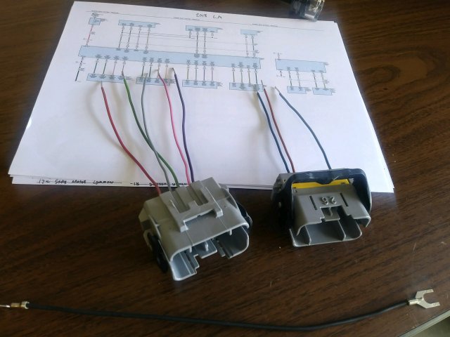

I am working on this. This "work around" will make the Power Tilt and Telescoping Steering Column operable again if you have removed the Driver Seat to put in a Light Weight Racing Seat or other Aftermarket Seat.

I guess I did not make it that clear. I am trying to make the Power Tilt & Telescoping Steering Column operable again after someone removes the Drivers seat to install a light weight racing seat.
nope
11,025
I am working on this and I am at a point where I need a car to test on. I am in Pasadena California and was looking to see if anyone had a need for this that is close to me. This "work around" will make the Power Tilt and Telescoping Steering Column operable again if you have removed the Driver Seat to put in a Light Weight Racing Seat or other Aftermarket Seat.
I also need to get your ideas.
It might be able to be made extremely simple where you are responsible to insert some pins in a connector and then tape everything up. The cost probably would be minimal if I can get a cheap supply of pins.
Second choice will likely be I supply a connector that you plug in and that is it. This option will most likely be $125 to $150.
It is possible that neither of the above choices will work ( I have not been able to test this out yet), and in that case a Harness/Connector AND a module will be needed.
In this case if you used the module out of your original seat the price would be in the $175-$200 range. A redundant module to work with this setup would cost $75 more.
It's possible it would be advantageous to do this at the same time as a driver side Airbag Light bypass harness and allow the cost of that to be a little less (usually $175).
I might be able to test remotely if someone had a Car and the need and was really good with a meter and can follow detailed instructions.

You need the module from underneath the seat . I started looking into this a while back but put it on the shelf for a later date . It was getting expensive , the demand wasn't high enough and I didn't need it as I never use the electric column controls anyway.
I honestly think it might be possible to do it without the module. FCA prints can be confusing because the nomenclature changes depending on what that the desired effect is and the differences in the hardware/devices. I am only trying to do this because several people have asked me for it. It would also be a nice option to have with the Bypass harnesses I make to turn off the Airbag light.
I am 99% sure it can be done with the module and a seat wiring harness. But if my theory is right, it could be extremely simple. I just need a car to measure some circuts on and do some very careful testing. That Steering Column Module is $300 and I bet it would be a bitch to change. If I had a power steering column on my RedEye this would be ready by now. I would have no problem testing on my own car.
My other project is for my Friend Hellcat Dan. He wants the ventilated Driver seat to work when the Pass seat is removed. Even though it costs more we went with a New Seat Harness and a New Redundant Module to fix his problem. Parts are on order. This way the Seat Fans along with the seat Heater and Steering wheel heater will run using the Radio screen just like OEM and no other wires or switches need to be added to the car (it's a Demon). Plus he would not let me test on his car.....Gulp:rolleyes:
11,025
Fantastic.I hope you get it to work. Like I said I tried awhile back but shelved it. Keep us posted.

Dan's Driver Seat Vented workaround should be tested soon. I have the new parts in stock and will make his harness soon. He will have an integrated workaround that will include the airbag light / seat belt light and his Driver Seat heating/cooling with the Pass Seat removed.
Thanks to @Marc W I now have the parts to test the Power Steering Column workaround. I paid for another day on Tech Athority and did more research. I am going to test some other possibilities but the safest and most likely workaround will be to include the module. I hope to get this done Tuesday if my Friend is still down to do it.

OK, I now have the setup to get the Power Tilt/Telescoping Steering Column to work again when removing the Driver seat. I finally tested it today and it works.

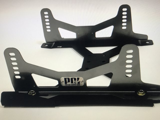

On the subject of race seats..... Ron... is making some great advances to allow these to work. Here’s another one.... Pro Car Innovations. I talked to him today about the Hellcat. He does not have a layout available but would like to make it. Real race seats are side bracket mount and these are designed for those. They are adjustable by changing the position of the seat and locking it down. Much safer than weak ass sliders. I’ll attach a pic and you can see how that would work. This place is in Chino, Calif. not far from you Ron! He would love to get a Hellcat in there and design one for us. 714-243-8526. D314FAA3-7EA6-40FE-9672-73276E437CC5.jpeg

Can you post the wiring diagram? Could have a CAN or LIN bus that needs to be present.
