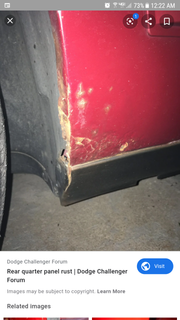

I'm sorry to disagree but I don't want the thread starter or anyone else to think these cars won't rust. Dodge sprays foam in the front of the rear quarter panels and this holds moisture and salt. Causing rust. I've seen pics of late model challengers worse than this. Screenshot_20191010-002257.png

Wow! I am glad the bottom of my rear quarters is not metal. The rear bumper wraps all the way around to the wheel opening.
The area most prone to rusting is the (front) of the rear quarters by the doors. Not the rear of the fenders that is plastic 1/2 way up.

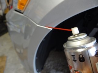

4 door LX's don't have the same quarter panel insulation foam area as Challenger's. However, just about every make can have rust develop in the bumper joint lines front and back. I've seen plenty of early LX's now with that rust area. The key is, like regular power washing in general, is to keep those joints power washed, even if you have to push down and spread the joint area to get a good shot of water in there to push out any grit. I Don't have this problem on the Magnum, nor on my wife's Mazda 3 which are notorious for this rusting area. I also give those joints a shot of rattle-can Rust Check spray every spring and fall as well.
