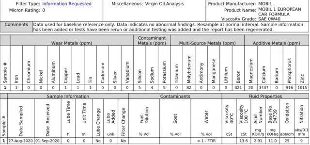

Here is a recent VOA on Mobil 0w-40. Boron = 300+ ppm.
While PUP 0w-40 has higher levels of Moly.
Both are great oils though, just formulated differently. Many have indicated Moly does better in the Hemi (smoothness), thus why Moly is used in PUP vs. Boron?
