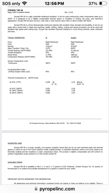

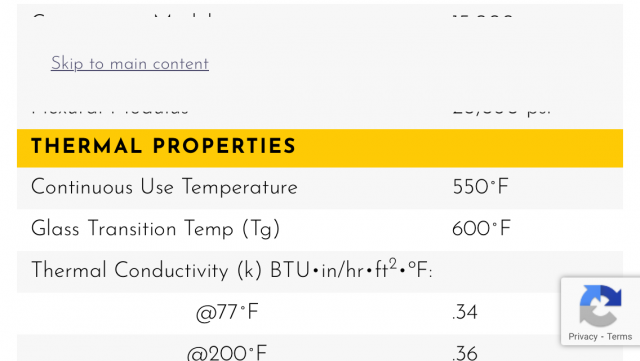

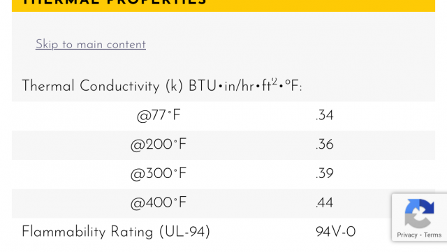

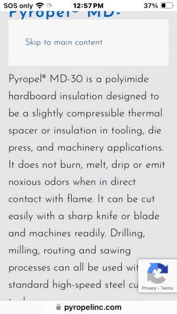

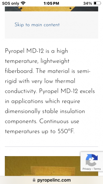

What is pyrol? Can’t find anything about it
3,630
8,538
Sorry, spelled it wrong. It’s an insulation material that stands up to abuse with very high insulating traits in a very thin and flexible fiber board. I sold a few years back but couldn’t get any more material as it has minimum order quantity’s IMG_9524.png IMG_9520.png IMG_9521.png IMG_9518.png IMG_9517.png

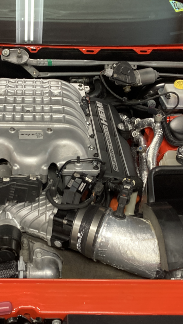

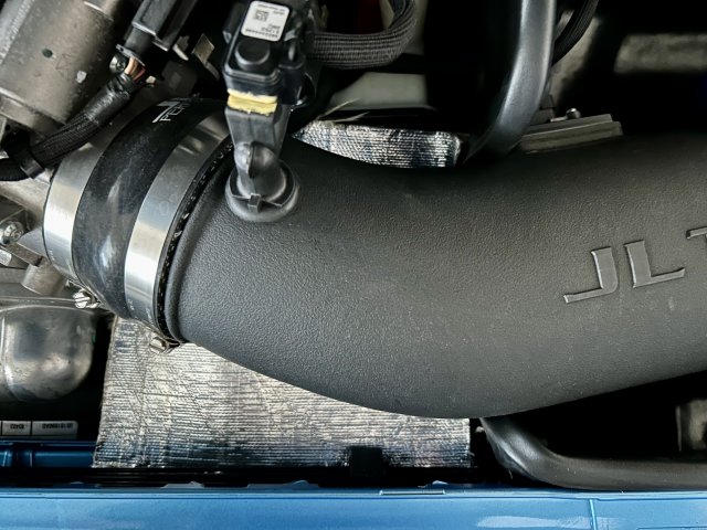

I don’t recall the name of the material I bought from 16GMG a few yrs back but it does a great job of blocking, and insulating, the hot air from hitting the intake tube, especially when the fans kick on. He cut it to fit my JLT, which I believe he had at the time as well. As anyone who’s been around here for a while knows, 16GMG knows his business, so anything that can be learned and used will certainly help!!! Plus he’s an M6 driver, like the rest of us cool kids around here!
Edited to add, here’s a pic. I had to uncover the car as it’s put away for the year.

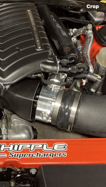

AFE I don’t have a template for (because I never tried one) but I can leave the air box area long and you can easily with heavy duty scissors or utility knife trim it to fit. Idea is to shield the intake tube best possible from the hot air discharged from the radiator fan.
My blower and intake tube are off atm I’ll put mine in place and take a picture of how it sits and fits with TB and tube out of the way
