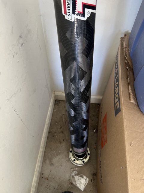

Do I have all the parts? Does arp make driveshaft bolts?

Is that one of those small diameter units they made briefly? Very cool if it is still together. My 2015 has their prototype still on it. We beat the absolute shit out of it. My buddy continues to love that car. You will never get your car as hot as we got mine up at BIR testing that thing. Good luck! If you need any help from QA1 let me know, they are about 30 minutes from me. Max High strength bolts should work that you can get at the store, I agree there.

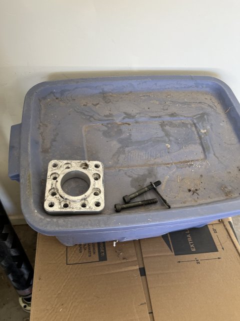

Yep. It was a dream. That is why I want it back in. Long story why it was taken out. Where does that adapter plate go on? Can I use the bolts from the dss that is on there now? Found out the vibration was from the dss.

You may be able to use the DSS bolts for the trans end. Adaptor bolts to rear and driveshaft to it. I have the old style DSS that is similar

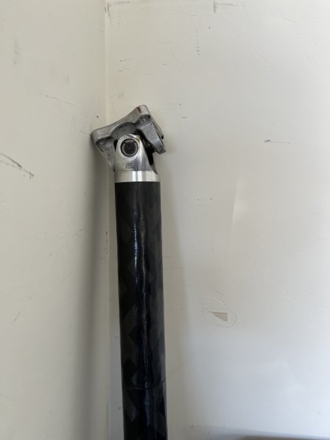

All the vibration is gone!!! It was the driveshaft. Runs smooth as can be now. The QA1 was missing installation hardware. And the customer service over there did not help me out. Maybe because they do not make it anymore? I had a brand-new aluminum, latest version, DSS, sitting in my garage with hardware. They installed that and it did the trick. Now I have a very low 9 second or high 8s car depending on elevation that drives like a dream.
