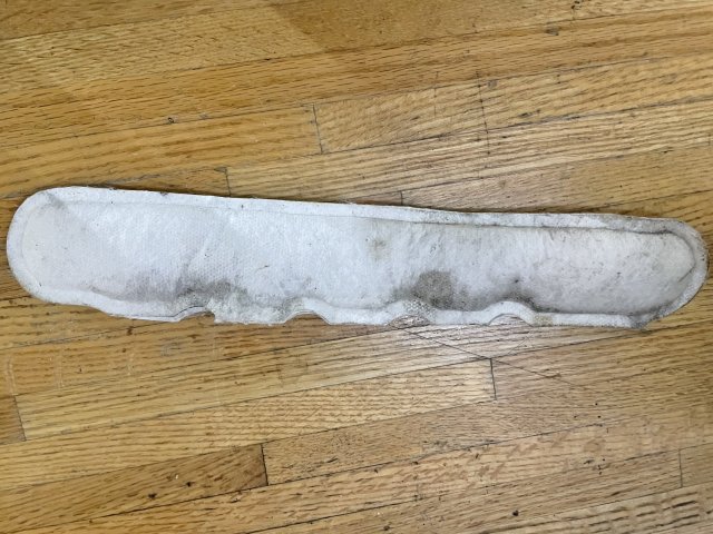

There is an absorbent pad under the chiller to catch the condensation.

hell on wheels
#1330
516
786
82
Saint Paul
Dodge SRT Demon
That I did not know
F34317A9-5077-40E1-AC82-3816B95F6682.jpeg If the adhesive fails and pad is out of place under the chiller.
Your car can turn into a one wheel wonder
If it gets hot out and the water drips down through the plastic covers on to the track.
