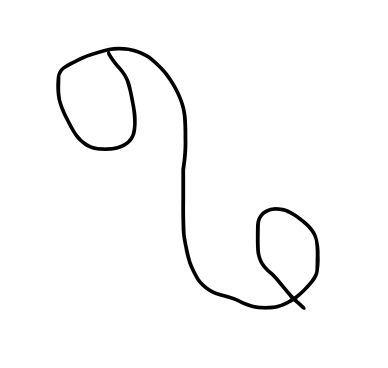

I seem to recall there we a few 1/8:-3/16" maybe hairline cracks that had started on the inner edge. If I remember right two or three were along points where the hat hardware was attached. more on the fronts than the rears. Didn't save them, went into the recycle bin, so can't give you any pics
Edit: none, as far as I could tell, went through the disk
Another edit: I was more concerned about the lack of safety wire on the inside of the mounting points

just a little something for peace of mind ... and to ensure hardware doesn't back out, not that that happened, or will
and yes, I know my skill at drawing on a trackpad is somewhere below crap
14,588
44,746
Thread Starter #13
I've done more safety-wire than God.
(see avatar)
