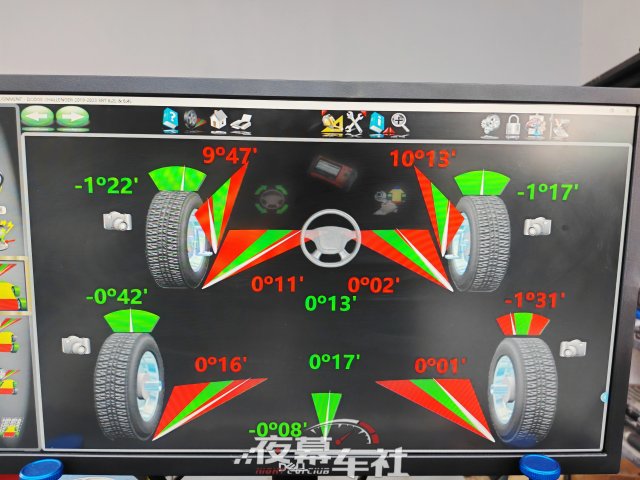

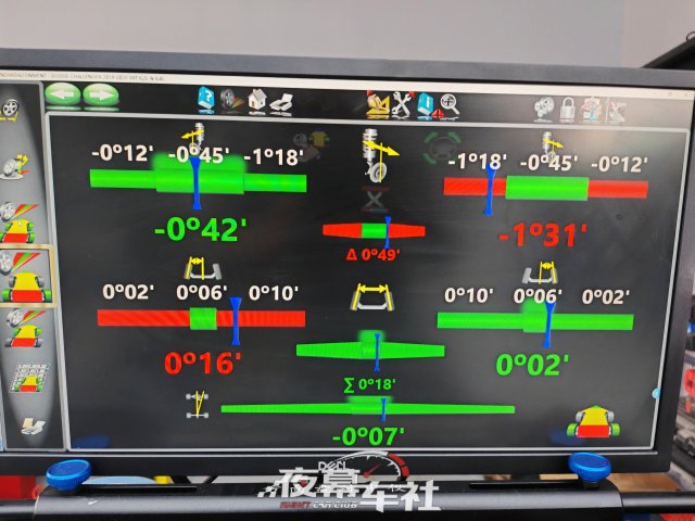

Hello everyone, I found an issue with the camber of my right rear wheel during the wheel alignment, but I can't seem to locate the adjustment position for the rear wheel camber. Could you please tell me how to adjust the rear wheel camber? Thank you.

Camber is not adjustable. Try to adjust toe and then see what it shows.

Thank you for your help. We tried to adjust the toe-in, but the wheel camber didn't change. It's a new car and hasn't experienced any severe impacts. Could there be any other issues affecting the wheel camber, such as the shock absorbers or something else? :unsure:

-1.3 degree is within spec in the rear. -1.3 to -0.2 degree all ok on the rear camber FYI.
Thank you so much, I’ll try my best to forget about that -0.01 degree.:ROFLMAO::ROFLMAO::ROFLMAO:

Hello everyone,
The issue with the rear wheel camber has been identified. The initial wheel alignment was performed with a machine that had not been calibrated, resulting in incorrect measurements. Yesterday, using the Hunter wheel alignment system, the values obtained were left rear: 1.05°, right rear: 1.22°. During the inspection, it was also discovered that the shock absorbers installed are Bilstein B6. This raises suspicion that the vehicle’s original shock absorbers may have been replaced before it entered the Chinese market. Could you confirm whether the original shock absorbers were Mopar components? Thank you!
