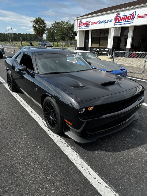

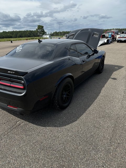

8,508
7,435
These are 315s standard body backspacing 10” wheel with a 14mm spacer/longer studs
8,508
7,435
I go back and forth on removing them all the time. I had a shop paint match them to the car. Have the front but took them off
8,508
7,435
Put some ppf under them and glad I did. Can see where the wiggle I guess under wind and vibration. These are on there pretty good with tabs and (gasp) magnets
Why spacers?

Extra room for the 315s. Yes I sledge hammerd inner fenders

they also still wanted to rub the back of the plastic well liner without them. It’s no big deal, they’re perfectly safe. Installed longer rear stud in new hubs, and they’re hub centric. I also have the aluminum spacers rtvd on the inside of the wheel to take up the extra space of aftermarket wheels so they actually mount and sit round directly on the hub centric spacer lip
