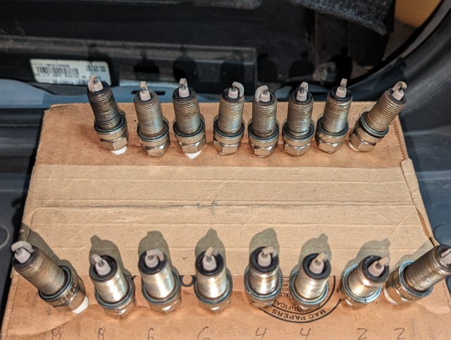

Hey everyone, always so much good info here. I am having my spark plugs replaced on Thursday, 53k miles on the car and it still runs fine. I will be sure to share pics of the OEM plugs that we take out.
So I am installing the factory Bosch iridium plugs SP196724AC and I am having it done at the dealer so they will obviously know the OEM spec, - but I just want to have the proper info as a backup. Car is still stock for now.

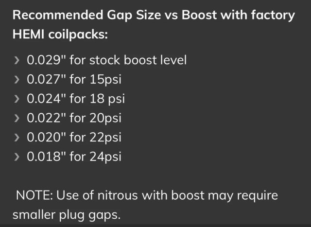

I ran .028 at 22 psi when I put my whipple on. When the car was apart last winter I went to .025. I ran .028 with my Mustang also at 22psi.
8,659
7,629
I went .021 this time around for good measure. I was making 17 lbs of boost, will be making more
8,659
7,629
Also run e85

For stock boost levels, yes. What plug gap do you run with your boost level?
3,750
8,902
At 30 psi of boost when I ran the 3.8 Whipple I was running .018”, still set there at 25-26 psi I’m running now with the 2.7 IHI blower.

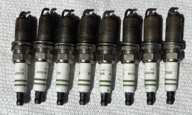

…and if you want to see what 6 year old 53k mile spark plugs look like on a stock tune redeye:
7,471
19,633
I don't see anything wrong with those plugs other than you need to romp on it a bit more often :LOL:
I don’t recall my stock plugs being Bosch but that’s a 2015 regular hellcat

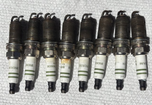

52k miles, stock 2017 HC plugs:
