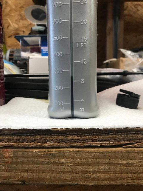

1) Oil capacity is DEFINETLY 7 quarts for just motor with oil filter change. I decided to go with the standard MO-899 filter because that's what was on the car and on factory Demons and has big round feed holes into the filter media. I have an SRT filter (MO-041) on my other 6.1 SRT8 at last oil change because supposedly it has a stronger relief spring and other improvements but when it was revealed by @BULL that some of the feed holes to the filter media were squished kinda flat and didn't look all to promising for flow I said "screw it" and went with the good old standard.
2) Some say the oil cooler only holds a few ounces and it's not worth draining. I found mine had at least nine. I drained it directly into an empty oil can and then put that amount into an empty oil quart container and recorded the amount. It was then that when I went to fix 'a problem' some slightly more had drained out and on the ground.

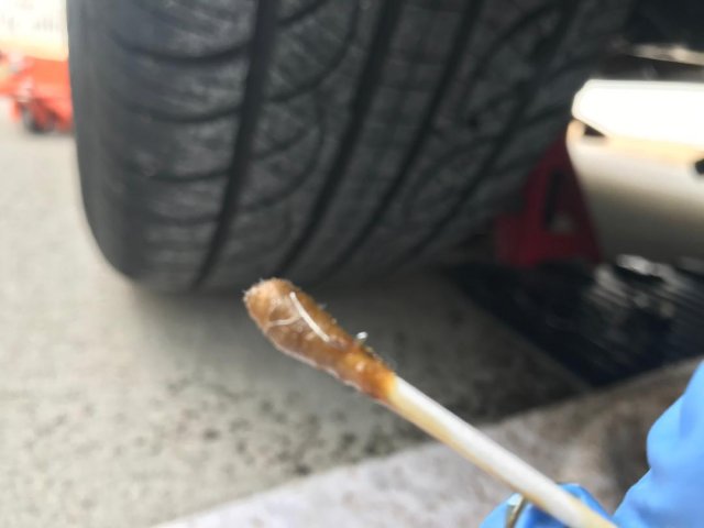

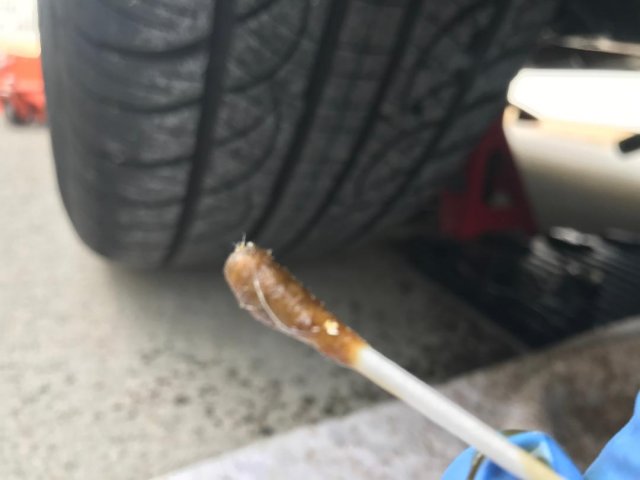

SIDE NOTE (the problem): When I removed the oil cooler bolt it was barely torqued down at all and had 'drag' on it the whole way out. Came to discover the bolt had bad flat spots on the threads and was binding/scoring the aluminum threads into the cooler housing. Thank god no cross threads. I filed the bolt threads with a micro file at flat spots and cleaned with a brass then stainless wire brush and came like knew. I recorded some of what I pulled out of the cooler threads also. Put bolt back in on cooler and pan and torqued both to 20 ft. lbs.
NO ONE AT A DEALERSHIP/STATION WOULD EVER TAKE THE CARE TO FIX/CLEAN/MEASURE ANY OF THIS. SO I STRONGLY ADVISE IF YOU'RE PHYSICALLY CAPABLE...…..DO YOUR OWN OIL CHANGES!
Sooooo :sleep:, in summary, I found motor, filter, and cooler drain require 7 quarts 9 ounces to be completely drained and filled correctly. How do I know? When I checked dipstick this morning (with cross hatch on stick FACING THE CRANK) it was exactly at the full mark at the top of cross hatch and just touching the hole above it. Just the way it came from the factory first day I got it. Hope this helps someone.
