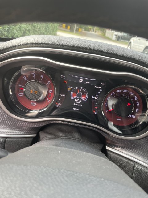

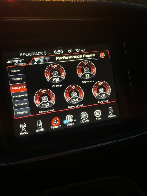

Yesterday while driving the car under acceleration would shut off and I would get a red lightning bolt in the dash. Upper left. Some have said the alternator could be going or that the throttle body needs a re-learn. Has anyone encountered this? While it happened, I put on the performance pages to see what was going on and car looked healthy.
Of course this happens when I don’t have my laptop.

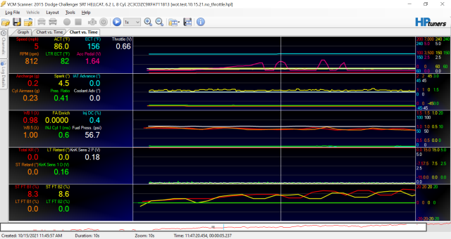

Okay so went back to a known safe tune. Dropped 1-2 shift to 6200 as thats the one I was banging off at the track. Did a throttle re-learn. Got this again.
Did the throttle re-learn again on the side of the road. Very important. On the last part of the re-learn with HP Tuners do not start the car for the cycle the ignition step. Turn ignition off. Then put ignition in Run/engine off.
Took it on the highway and she felt fine. I think that the changes to Torque Mgmt and turning off ETC A/B might have been the culprit. Well thats a note in my small book on learning how to tune the trans.

Yeah, just looked at the logs this time. For sure was an issue with throttle and accelerator pedal not syncing. The re-learn made it happy, which means I'm happy, which means racing tonight!
Purple line is pedal, white line that doesn't move is TB. Good thing I was with the laptop and only 60 ft from the house when I hit the gas and it went no where.
