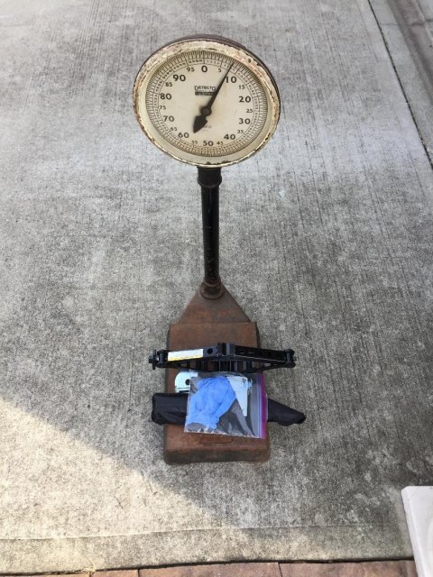

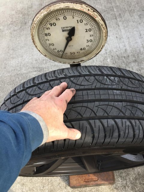

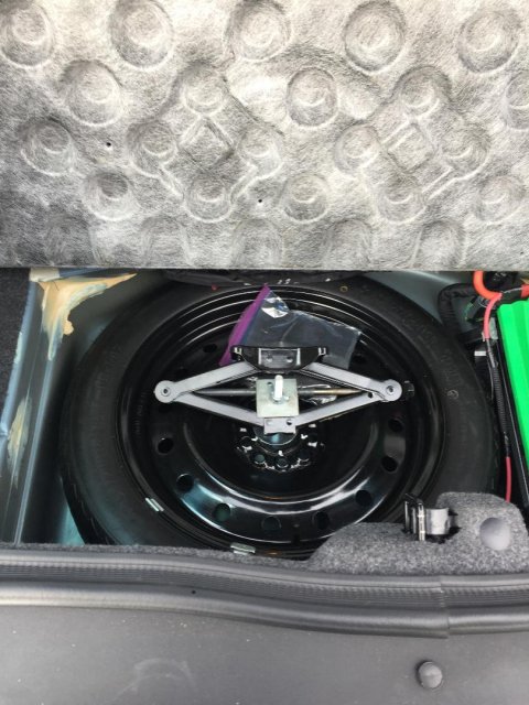

Today I removed the Performance Spare tire (from Performance spare tire co.) I put in my '09 SRT a few years back. I was hoping to transfer it the RE I recently bought. Did a test fit and would not clear the bigger front Brembo's by just a hare. But there's a bit of irony here. Yesterday I removed the rear seat delete from the '09 to put in the RE at a later date and it was determined it saved 48l.bs. Guess what the performance spare and hardware weighed?.....47.5 lbs.!!! So net net it was a wash. If you want the comfort of having a "real" spare and want to keep car same weight, do a rear seat delete. LOL. Just FYI while I had the RE tire /rim off I weighed it. RE rim with stock P Zero (275/40) was right at 57 lbs.
You might be wondering why this became an issue or point of interest on my '09. Short story--- My wife and mother were out a few years ago in her RAV4 and she gets a for real, true blowout. Thank God it was the rear tire. The entire sidewall just disintegrated and shredded.(Dry rot?). I go and change tire. Next day replaced all tires with new B.F.Goodrich rubber. But then I thought "what if I got a blowout, not just a flat?" So I look up spares and found this co. Not cheap (@$300) but fit front and back perfect. They give you a jack but it's sh&*. I bought an OEM Mopar scissor jack off eBay (more money) that worked perfect. Does anyone know if Mopar makes a spare to fit over the huge Brembo's? Would a 300 SRT spare work?

Ok......I went through some of this spare tire dilemma earlier this year. I decided that I wanted a spare tire more than a giant hunk of styrofoam, I think the tire will roll better when I put it on. I found spare from a 2007 300, jack tire, hold down hardware etc., and all together I paid around $20 for everything. I got everything home and tried the spare on a the rear of my car and it fit with no problems. Move it to the front, and it would not clear my 4 piston Brembo's. So.....back to more research. It seems that a spare from a 2014 and up LX platform car will fit over the 4 piston calipers. The p/n on the spare that I bought was 04782465AA. This spare needs to be used with a spacer on the front.
After more research, this is the p/n for the '14 and up LX spare that is supposed to clear the front brakes and doesn't need the previous spacer . The rim is supposedly stamped a little differently to clear the brakes. I haven't had much luck finding a 2014 and up in my local wrecking yards, but I keep checking.
4895689AA.
I have the spare also (Modern Spare). The Hellcat version comes with a spacer for the front wheels. Actually I don't mind the extra 47lbs because it's over the rear axles. With 700+ ft lbs of torque who's going to notice anyway.

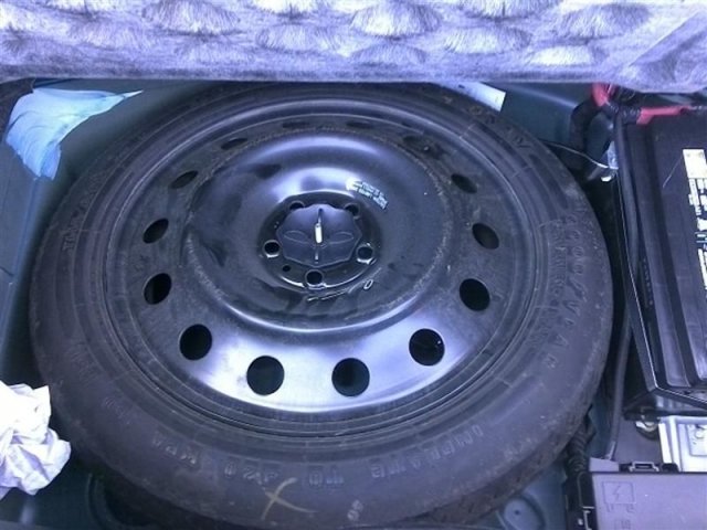

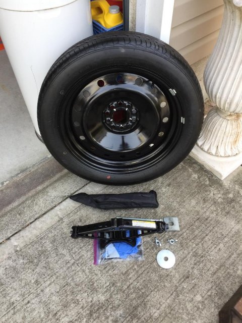

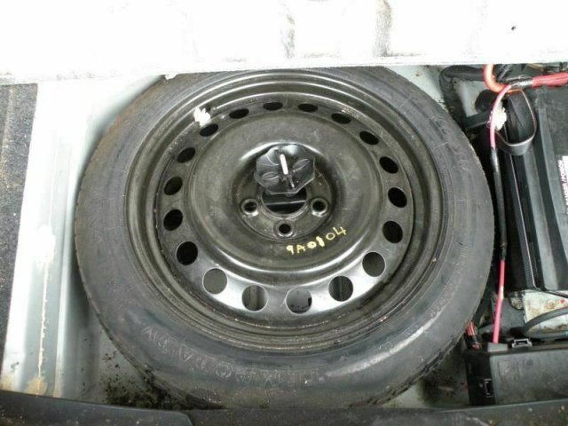

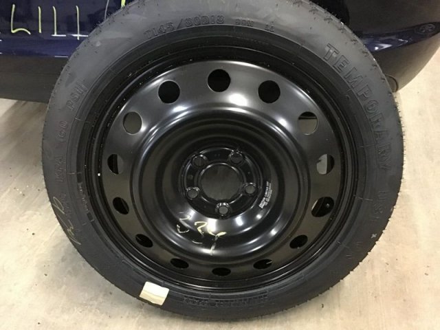

Agreed on all counts, that's why I tried to find a factory spare that actually worked without spending $300+ to do that, especially since I was able to get everything at my local wrecking yard for so cheap. Unfortunately, the spare wouldn't fit over the front Brembos without a spacer. After talking with several other members with SRT Challengers who's cars came with a factory sprare, they all told me that their cars also came with a spacer that it about 1 inch or so. Those spacers are about $90, which I guess is cheap, but I just don't want to deal with one more item to haul around, or deal with in a situation like you mentioned above. Here are some pics below of the factory rims where you can see the difference in how the rim is built. The first one is the type of spare rim I originally purchased, which won't fit over the front Brembos (this isn't my car just a pic of the rim from the net). The center section with the holes in sunken further into the rim.Take note that it has 18 holes around the perimeter.
And this is the type I just bought. Notice the difference in the center parts between the two rims (the second rim only has 14 holes around the perimeter), but the important part is the center part is shifter to the outside of the rim which seems to be how they are getting the additional room for the brakes. I was able to find this on Ebay for $65 shipped. I'll take pics and post up results next weekend.

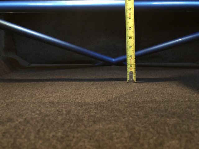

Can I please get an idea on how wide this tire / rim combo is at its widest? I’m looking for a spare that will both accommodate the HC’s large brakes as well as fit beneath the rear strut tower brace I just installed. Looks like Ive got about 8 inches:
I didn't know any SRT Challengers came with a spare. I thought only the pump/goop kit. But I did hear that 300 SRT's came with spares. Hope that works . Definitely a deeper offset in the rim.

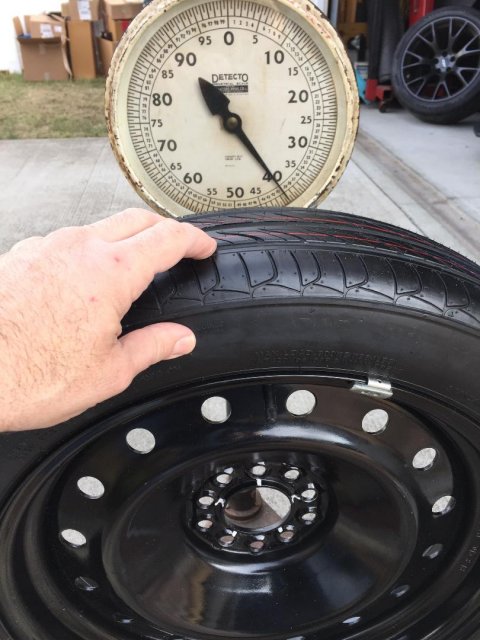

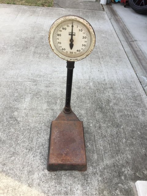

I'm acutally looking to use two of these as my front runners when I go to the track (after I change the tires of course). This spare rim and tire weighs in at about 32 lbs compared to my factory front rim/tire that weight in at about 60 lbs. This way I only have to bring one additional front tire and then my two rear with me to the track. I know they aren't the prettiest, but they are a lot cheaper than buying dedicated front runners that I will only use several times per year.
But if you swap out rubber for speed rated tire would it fit in well? Or am I missing something. I'm known to do that sometimes. LOL.
I'm supposed to have the spare that I just purchased by the end of next week (says Thursday on the shipping info). When I get it, I'll take the measurements, including weight and post them here for everyone.
The original one that I bought measures about 6 inches wide and 27.5 inches tall. I'm not sure how much the new one that I bought will change from that but the very middle might stick out a bit more. I'll know more when it gets here. I'll keep you posted then.
