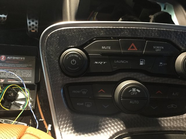

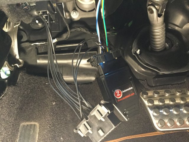

T harness plug for tuning and having the tazer hooked up at the same time. Comes with the HO tuning kit.

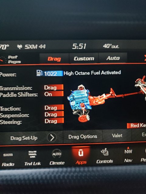

15818015471471914126123542943244.jpg 20200215_175101.jpg 20200215_182711.jpg

Do you know if it actually does anything to the suspension in drag mode?
14,718
45,214
Hemituner
#1284
82
242
Bayshore
2018 Demon
It invokes the Drag programming from the Active Suspension module if you select that option in our tazer.
Hope this helps

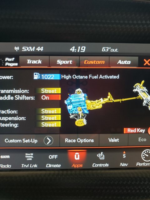

OK, let me get this right. Demon tuning for the Redeye. Fill it with 100 octane and get 840hp when hitting the HO button, just like the Demon. No warranty issues at all because the dealer can't tell the car is tuned.
if accurate, I'm all over this.
