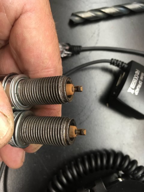

I've questioned what the issue is with the orange tint from MMT. I did some reading on it a while back. There was a thread on the other forum from a guy that put Boostane in every tank and a year later gave an update. No fouled plugs or any sensor issues and he used it EVERY tank for a year according to his report. I have about a half can left in my cabinet in the shop from where I tested it. It does work.

@Jack_Toepfer. Yes I was referring to the arbitrary color. It shouldn't matter if it works. As long as no oil, pitted or cracked porcelain and knock sensors are reading good. Yes also agree the plugs, chambers, exhaust pipes etc. are also coated, even when not orange, but I don't know what's a harmful coating for sensors and cat's. If the orange (MMT) coating is not harmful I wouldn't be bothered a bit.

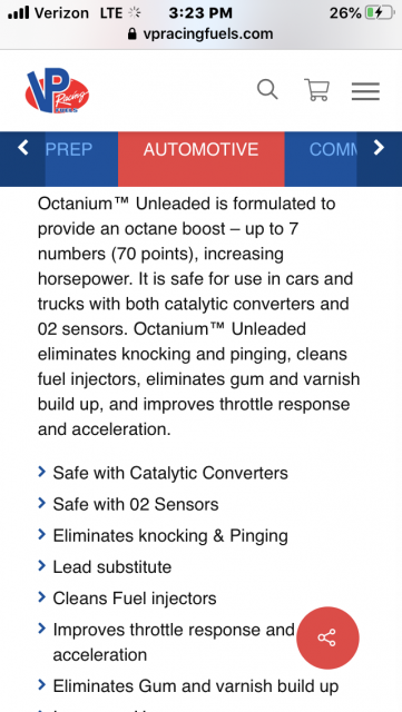

Octanium Unleaded formulated a bit different then past octane boosters, it does work well.

Orange crap on everything would be a pretty good indication of MMT usage, and grounds for voiding Mr. Warranty. You might be able to pull and change 16 plugs (brand new - LOL) but not every nook and cranny full of Dorito dust. That said, I am not buying the addition of methanol to the mix being causational or detectable in the face of a failure - that's a stretch.
