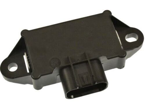

Got a question pertaining to the fuel control of a 2015 SRT392 Challenger. I am building a modern 70 RR with all 2015 Challenger drivetrain / Electronics / all wiring ...etc. My question is...Does the 2015 Challenger SRT392 have a separate Fuel Pump Control Module? (Part # 68193711AC). All other Challenger Models have this Fuel Pump Control Module mounted in the truck on the drivers side . Half of the MOPAR parts web sites say that Part # 68193711AC DOES NOT FIT my Vin # . Can anyone shed light on this???
Look in your Trunks on the drivers side behind the panel and see if this module is there on your 2015 SRT392 Challengers.
Thanks in advance for the assistance
just seen this an went on pro demand an there is no fpcm used on both 6.4 an 5.7 2015 challengers. doubled checked wiring diagrams. in hellcats they have them mounted in trunk on right side.

even though there is no fuel pressure control module, you still need pressure to be regulated so I suggest you use same fuel pump module that the engine an wiring came from. the regulator will be integral being that its a single line system.

The fuel pump regulator is built into the siphon pump assembly on the right side of the fuel tank.
