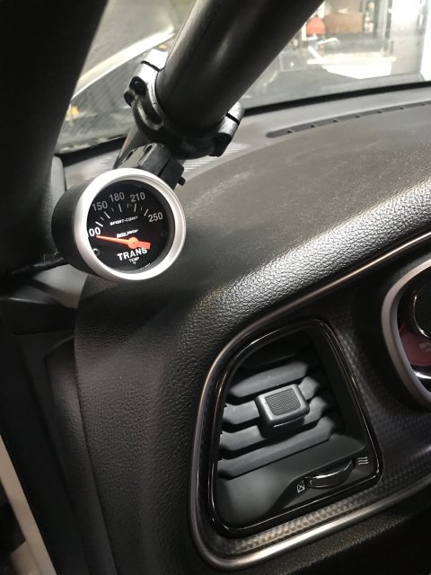

As far as puller mounted gauges… Z’s right. Bar mounted pods are available. Here a old pic of my trans temp gauge. F1E4F26F-17F5-4D8F-A603-6304E5554387.jpeg

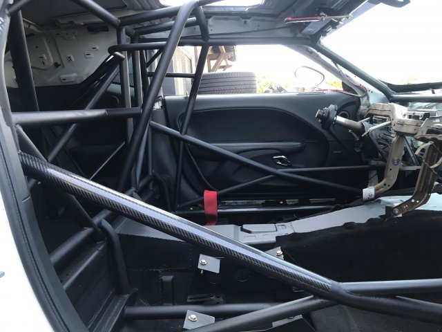

This is my cage when it was 8.5 cert. In street mode with the drivers side door bar out. Pretty easy to live with. 8F8961F6-34F3-4DED-8F3F-6D2C1F094847.jpeg

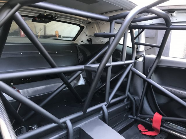

This is the upgrade to the 7.5 cert. lol. What a difference a second makes. 192CC5C7-E5E4-42D2-A605-382C4D6165CD.jpeg B8F685B7-F0D7-4ED5-BFAE-A7D1BCD08753.jpeg
