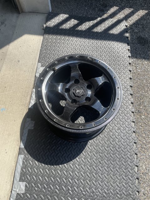

Created this video on how I setup my bead-locks myself. From start to finish.
If you have any questions about the procedure don’t hesitate to ask.

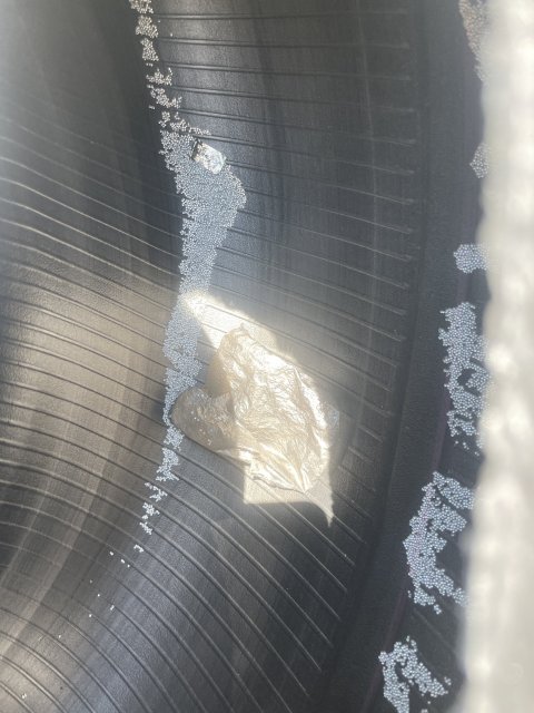

The latest thing is some type of bladder inside the slick.

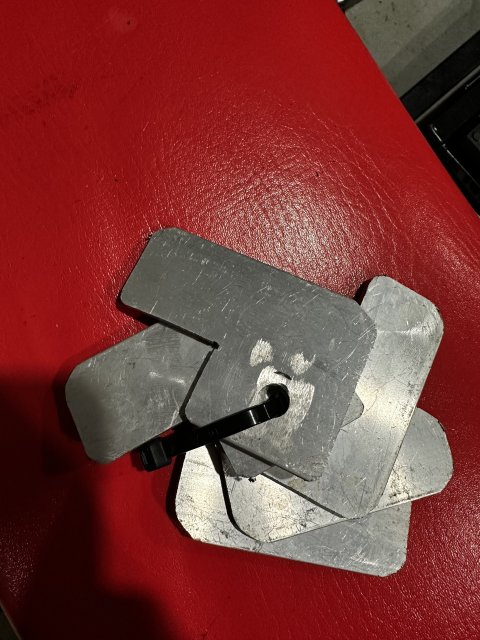

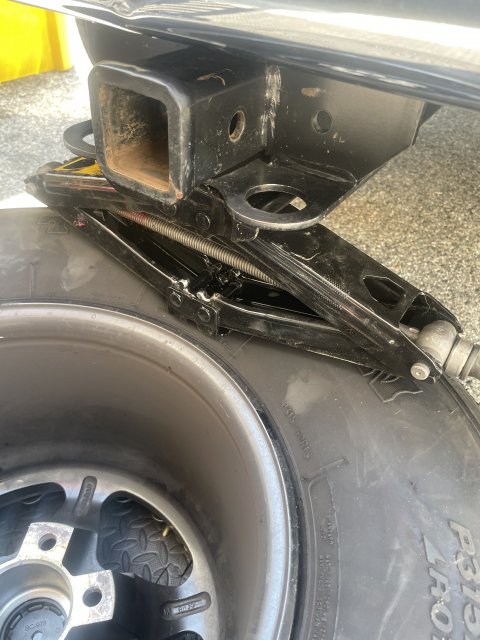

I made tools to hold the tire down. L’s with a hole. You screw 1 bolt in, work around the tire and the tongue in the L holds the tire. Made like 6 of them out of aluminum. Some wheels (welds) are easier than others

Yea, those have been used in Blown alcohol and Pro Mod for a while, aka liner tires if that's what you're referring to - they can be a real mutha to install, and have to cut the the outer tire off to de-install...

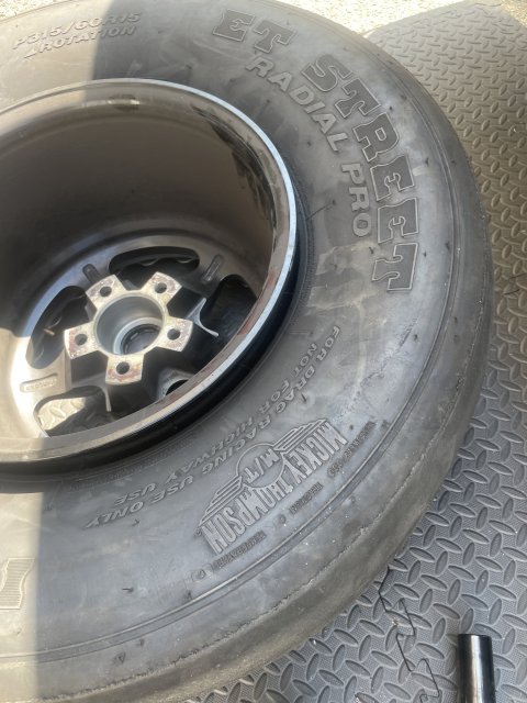

Can’t with the small lip on the F14 headlocks, tire slips right off when you get to the last several inches to stretch the tire. It’s a poor design. This is with the 315/17’s. The little tabs make life so much easier. Do 1 wheel in 5 mins with them

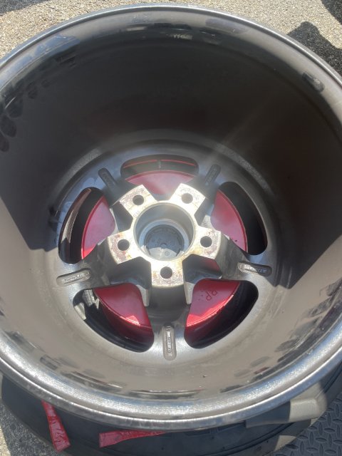

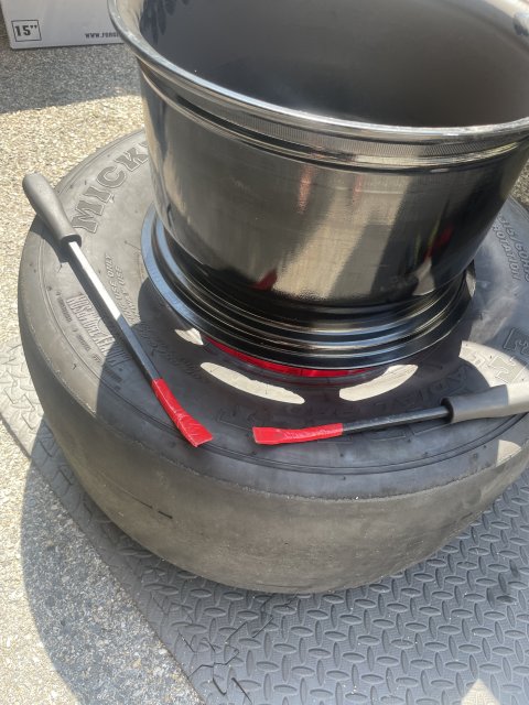

Unmount is even easier

You didn’t do it all the way I’m not convinced lol. Also I didn’t have anything to rest other side of wheel on I did it on the floor. It was free aluminum I had laying around. Telling ya the 17’s are crap to do

The 315/50r17s are stupid stiff, and have a lot of extra material.on the inner bead section

I’m fairly strong, it’s that not easy with 315/50r17s. Show me a video of someone doing it by hand on them without locking them into a tire machine or something to hold the wheel or not using tire irons

If I cut some of the material off the tire it probably would have been a bit easier
