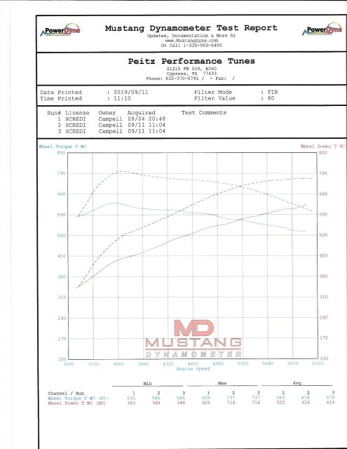

Well my baseline numbers are in. Two things, first of all it's 100 degrees down here and it's a Mustang dyno in a none air conditioned shop.
RWHP = 630 Crank HP = 725. It looks like the numbers are IMHO 10% too low. I know the heat plays in important part and I know going in the Mustang dyno brings normal men to tears.

I picked up 98 rwhp by the mods. She's good to go on 93 octane. Mods are 2.85, catless mids, 180 stat, engine and transmission tune using HP Tuners.
