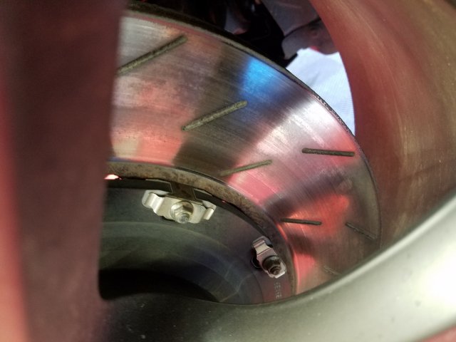

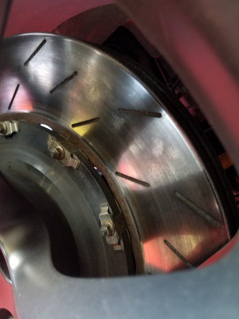

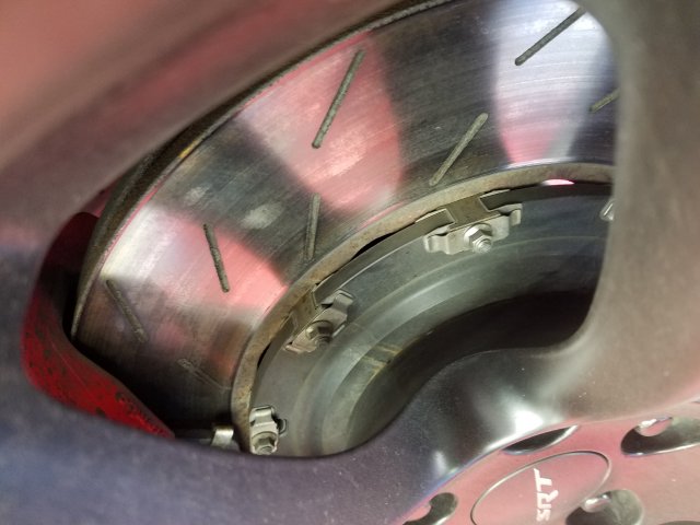

During my last wash I noticed these discolored spots on my front rotors. I'm getting a shimmy during braking on the highway. I've have z26 pads since I got the car, they have about 35k on them. Debating on going back to the dust machines. 20191008_121603.jpg 20191008_121609.jpg 20191008_121620.jpg

The shimmy at highway (or any speed for that matter) usually means the lug nuts were not torqued with a torque wrench at some point and have been that way for some time.
The marks/spots on your rotors could be the warped rotors slapping at the pads. And no, it's not the Z26s. Many of us are running Z26s with zero issues....

Looks like heat spots on the rotor. If there is a shimmy, rotors are probably warped. Warped rotors will cause shimmy/shake during braking - obviously more pronounced at higher speeds.
