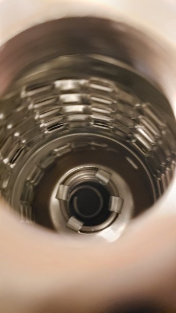

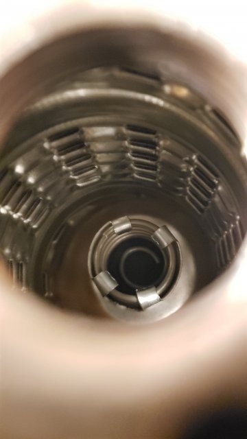

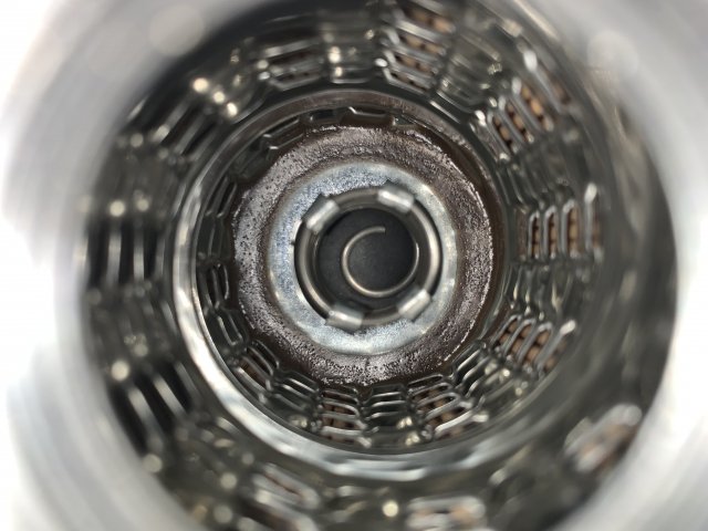

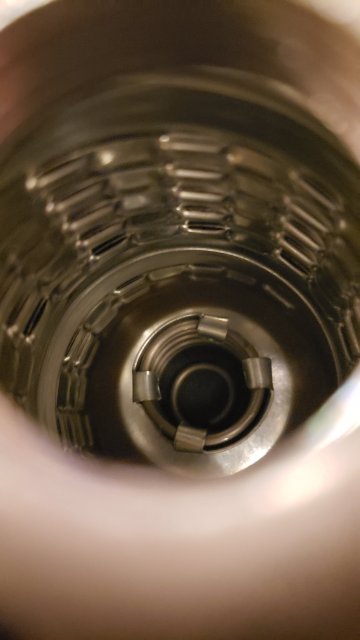

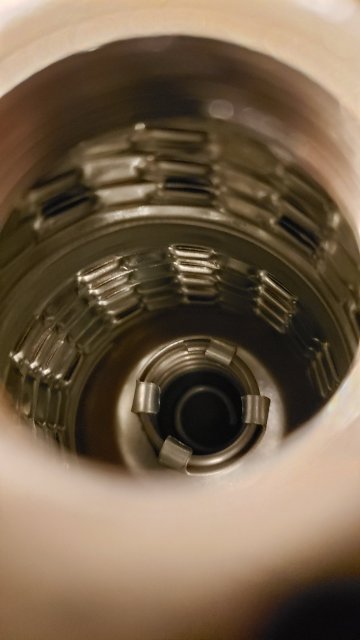

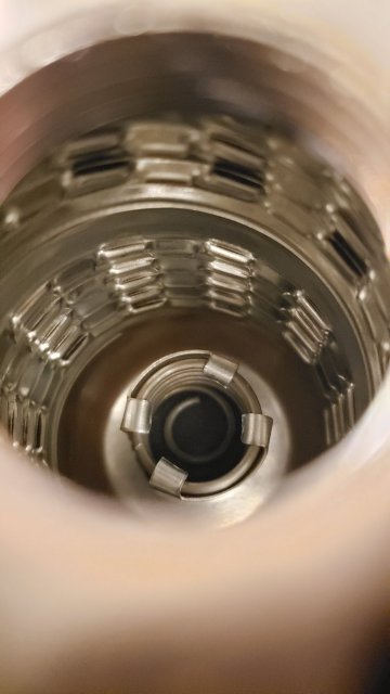

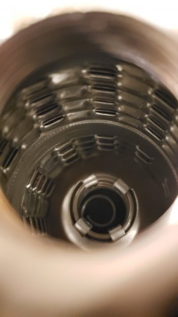

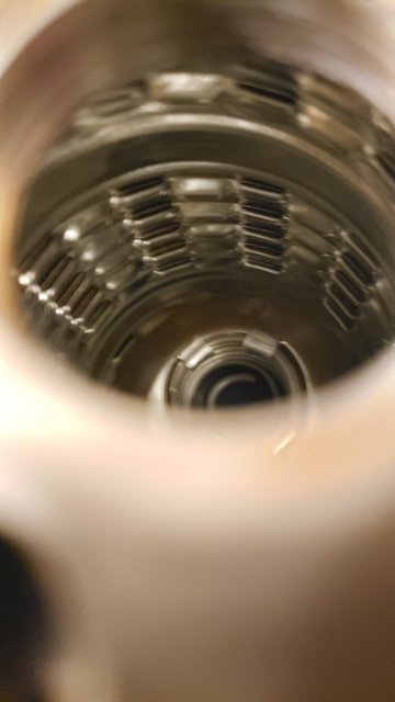

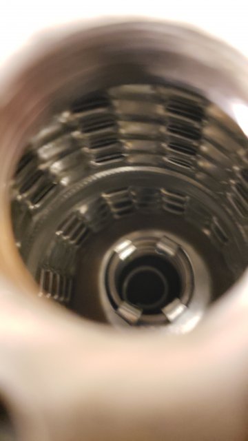

A while ago, another forum member @jroyk brought up an issue he discovered with the SRT -041 oil filter. It would seem that despite the high grade and specifications of this filter, there appeared to be, at the time, some manufacturing quality issues.
The holes (louvers) in the center section of the oil filter were poorly stamped and seemed to be restricting flow through the filter, at least from a visual inspection standpoint. Some pictures were posted and they clearly showed the openings in the louvers to be nearly non-existent.
At the time, I had two on the shelf and went and took some pictures and discovered the same thing, of the two, one was "open", the other was either nearly, or actually closed (referring to the holes created by the stamped louvers).
Jumping ahead to now, I used the last of my "good" SRT -041 oil filters and needed to replenish my stock. I like to keep at LEAST one oil change worth of oil and filters on my shelf for all of my vehicles.
And knowing that this might still be an issue, I ordered up 4 of the -041 filters with the intent of inspecting and then if need be, returning any that didn't pass a visual test.
Here is what I found... Sorry for the less than perfect focus and lighting.

I have not, and won't for some time. Based on what I see, I'm returning #3 and #4 as "defective".
The thing about pressure vs flow, I don't suspect you'd ever know or see it from your dash. If the flow was restricted enough due to the louvers being "closed", the filter would simply bypass itself so that your engine was still seeing pressure/flow, but now you're not getting filtered oil...
(The spring seen at the bottom of the images)

I was that other forum member that brought up the QC issue. #3 and 4 look like my last 041. I’m sticking with the OE, MO-899. Nice big holes in the center tube and was OE on Demons, so good enough for me. Perhaps the media in the 041 will catch smaller particles, but that shouldn’t be an issue with required short OCIs.
If you’re worried about wear particles, cotton gauze air filters should be a bigger concern.
