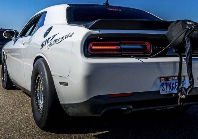

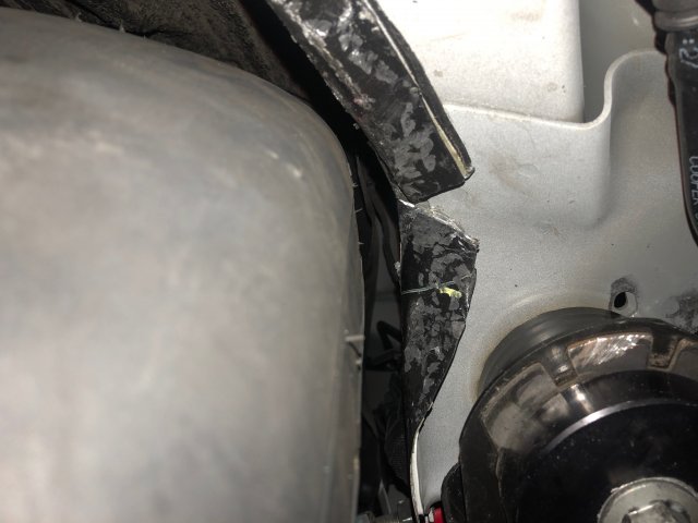

315/60-15 M/T Pro. Absolutely the biggest thing you’re going to get in there without ripping out the entire inner fender structure. E89A99F6-6B86-41F3-A177-F085C93A3C6D.jpeg 667E88C0-D6F7-4C69-AB1B-F49273D4E90E.jpeg

Hunter, Blkout - did you guys do work to the inside well like Marc did?
Thanks all for the great GREAT input.
No work inside the fender well, since the flares give you more width, the wheels have the offset to push them further outside the fenders.
