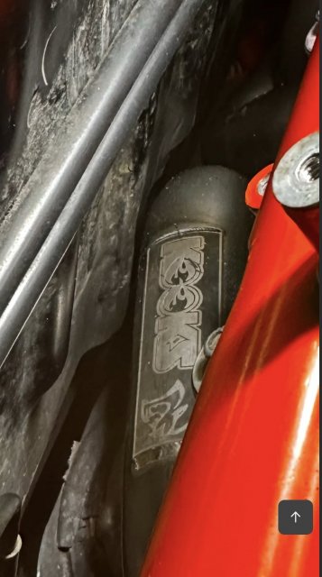

Can I ask you a question @ostmike? How close was the passenger side header to the rib on the shock tower? I installed the same headers and I have about 1/8th of an inch clearance. I cut some out of the rear rib because it was actually making contact. I also have your 1/4” spacers to drop the subframe down. I feel like if I didn’t have the subframe dropped the clearance would have been worse
I am going to let Micah address this question and our experience with these installations. You are correct in stating that this tube is tight and in some cases is touching and is audible. Micah will explain what he does to resolve.
On some cars the right bank header will be close or touching the shock tower. On these cars the front subframe is too far to the right. Loosen the bolts and pry the subframe to the left so it is centered. There is a lot of movement in the subframe. You will need an alignment afterwards. We've corrected this in the shop a few times so you are not the only one.
Thanks Micah! Extremely helpful!!!
8,043
6,952
Another place told me hellcat cradles can’t be shifted over, which I found odd - they’re all the same. I’ll get mine moved over and aligned. Great info
