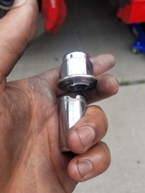

So I broke one and my friend helping me broke one. We were able to take the wheel off and get the nut off the stud with some pliers. What part number and brand would be a stronger option?

They broke where the head goes to the sleeve. With a torque wrench. He broke one and I broke one. They were easy to get off the studs with pliers . Thanks Motorhead.

For a shank style lug nut to function properly the wheel stud must be long enough to reach into the nut portion of the lug nut. If it's just in the shank portion then there's nothing holding the wheel to the car other than the thin 'wall' area of the shank. Threads are a natural stress point in metal as well as the relatively sharp inside corner where the nut meets the shank. That's why they break where you're describing when the stud isn't reaching into the nut.
I have never put a shank style wheel on my car so I have no first hand knowledge about your wheel/lug nut/lug stud combination. I'd personally check to see how much stud you have sticking out past the wheel and washer. The part sticking out should be equal to or more than the diameter of the stud. So.. a little more than a half inch at minimum.
Hope this helps. This sounds like potentially a very dangerous situation.

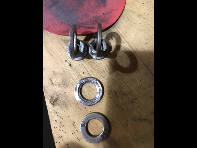

I’ve snapped a Summit one , IMO they are no better. The shank design is just shithouse and a pain in the bum . I made a set of much better quality washers that don’t deform and get stuck which helps and take a box of spare bolts/ washers/ hub centric ring to the track . D1C31CA3-76B6-45BD-85EF-73DA6EC43937.png 2AEA8AB5-720F-44BF-B142-2466A4872365.jpeg

Thread Starter #18
I did not realize the gorilla lug nuts were summits brand.
Guys, Keep in mind thicker heavy duty washers actually make this problem worse. Longer studs are the only way to properly fix this dangerous situation.
