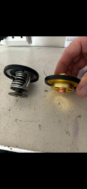

Buyer beware on those Jet thermostats, I’ve had a couple go out on me, they either start to open really late or not at all. I had read of other people having issues too with them on other chats. I’ve had one become separated inside the thermostat housing too, luckily the piece did not drop down into the water jackets surrounding the engine!
I had used them for years on my previous Hemis, don’t know if there was a design or manufacturing change? But they initially open at around 188 which is warm enough to not throw a code on the stock tune, versus the Milodon or Mishimoto that open around 177-179. Yeah I too would like to know which unit comes with the Direct Connection packages.
Stock unit versus the Milodon, Mishimoto is similar to stock design but I don’t have a picture of it.

Stock thermostat is here:
https://www.eastcoastmoparts.com/oe...zcnQtaGVsbGNhdC1yZWRleWUmZT02LTJsLXY4LWdhcw==
Mishimoto:
https://highhorseperformance.com/mi...-thermostat-gasket-for-5-7-6-1-6-2-6-4l-hemi/
Milodon:
https://www.manciniracing.com/mihith1.html?gQT=2
https://www.jegs.com/i/Milodon/697/...ODT_XDdfksksQmfealWbZCuKsjpBjMlxoCajMQAvD_BwE
