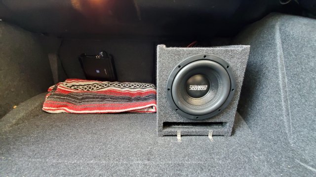

I have subwoofer in the truck with an amp, what are you concerns? 20200621_182903.jpg
