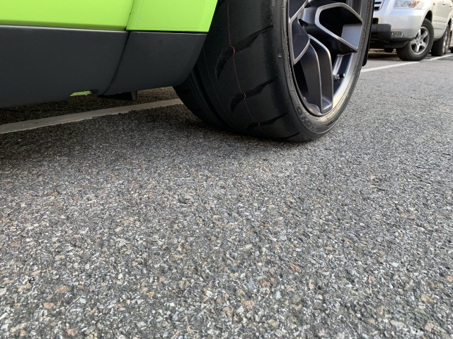

Great simple mod to stop that pesky non stop brake dust from the factory Brembo pads. Stopping feels great, break in was simple and now good to go. Cleaned up my wheels with a microfiber towel, gave them a coat of Nexgen ceramic spray and that was it. 3D4CE213-5FC8-41A0-AE91-1EFCEB86EBA3.jpeg 3D4CE213-5FC8-41A0-AE91-1EFCEB86EBA3.jpeg F1FB47A0-84B0-435F-84B7-F7CFB92D22F5.jpeg
