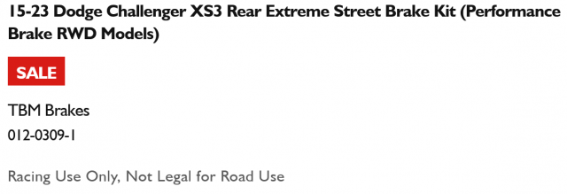

Has anyone tried the TBM XS3’s yet for a 15” conversion? Will 15” beadlocks out on the market clear them?

Yes they will fit 15's as long as ur not double bead locked. Bead needs to be on the outside. I learned the hard way with my Turbo Mustang. I used the regular ones then swapped and put the Baer Street brakes front and rear to clear both 15's and 17 inch RC Components.
But my buddy has these on his Mustang now so im sure they will fit 15's on the hellcat thats really the whole point of these brakes is to clear 15's and still be able to stop which u cant with the race versions wow the race stuff is utterly dangerous on the street geeez fuk that!
Honestly theyre not that light and work so-so. I would opt for the Baer stuff TBH but they probably are similar in stopping power. Not sure the price difference tho but the Baers are likely more money.

These are new and different, they’re not the scalloped rotor ones. These are specifically for street and track use

You should put up a link to them, I'm curious.
U
8,508
7,433
Cheaper than a set of new factory rotors
U
8,508
7,433
16 pounds per side

Does he have the new street ones xs3 that just came out or the older ones?
16,878
52,876
Interesting...
Food for thought..
