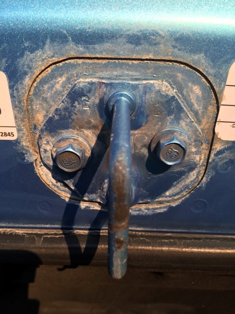

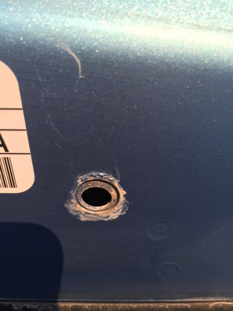

Hellcat owners should go after FCA for the improper design of 2015-2020 hoods. The steel latches/aluminum hoods are not treated properly causing a galvanic corrosion reaction on brand new cars right off the lot. You can sand and paint over but it's just a temporary fix the Dealer may do if under warranty or its on your dime. The hoods are corroding from the inside out due to a major design flaw. If not addressed it will end up looking like this around 50k miles or well after warranty is up in most cases.
Hellcat @ 600 miles after purchase.
https://www.lxforums.com/board/charger-discussion-3rd-gen-2015-/386958-corrosion-hood.html
The R35 GTR and many other modern cars have aluminum hoods/steel latches, never had an issue with others as they were treated properly. Dodge did a terrible job on these hoods, only fix is fiberglass or a carbon replacement unless they engineer a new one from the ground up.

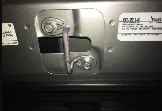

Now this a little different. I know one Hellcat owner that the dealer replaced his hood. My Daytona was starting to show some wear and it seems far worse to me that if it fails your hood will fly up

Replace the latch with stainless steel.
Yea a few have been replaced at Dealers. If one flys up causing an accident there will very likely be a recall of some sort. Matter of time really but based on the corrosion rate will happen well after warranty (10+ years) It's a trouble spot to watch out for.
You can clean it up and replace the latch with stainless but it's really a temporary fix as the hood corrodes from inside. The surrounding plate/holes will rust. Only a matter of time. Car could be spotless of rain/salt and still will happen.
My fix will be a carbon replacement. Will be set for a lifetime.
These new hoods are aluminum. I would think once the latch was replaced with stainless it should be good.
