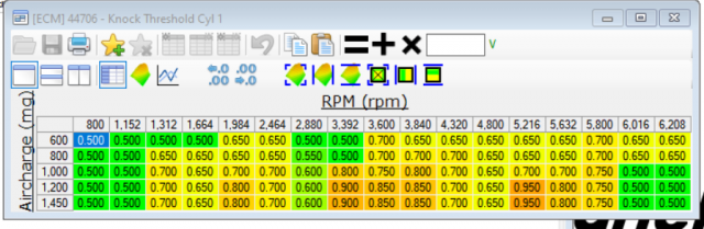

Let’s talk knock sensors. Logging Knock Retard is not enough. You also need to log knock sensor volts. If your knock sensors are desensitized or turned off just looking at knock retard you will think everything is fine. We have seen cars with the knock sensors completely turned off. There are legitimate reasons to desensitize knock sensors. A smaller pulley can generate more noise for example. There are many ways to rule out real and fake knock like pulling power from the car or using higher octane fuel and if the knock is still there it is most likely fake. Here is a picture of the stock knock sensor volts from a stock tune so you can get an idea of where knock volts should be.

Also of note is how low the factory thresholds actually are in the knock sensor tables. It's a 0-5V sensor for reference.
