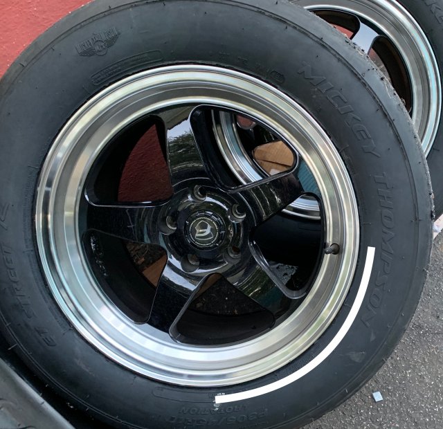

So out of curiosity I marked my new set of MT ET Rs that I just ran at the track. I made 3 passes on race start recluse 17x10.5 wheels (non beadlock). The left side seems to be the side that moved more (about an 1-1.5 inches a pass) the right side moved about 1.5 inches after 3 passes (about a 1/3 less). I also noticed the left side always seemed to throw down more rubber than the right side after burnouts. My 15' hellcat was the same, left side seemed be more torquey or dominate than the right.
Keep in mind I have a Redeye on stock power and I used Hi tack glue to keep them from moving. Hoping they settle after a bit and won't move so much, down the road. Otherwise beadlocks may be in my future. The other thing I was thinking though was that the tires shifting a bit like that might actually help take some of the drive train shock load. I've gone a best of 1.47 60ft with previous tires and 1.55 60ft (worse DA) this weekend with these tires so they seem to 60ft pretty well.
Does anyone think beadlocks would improve my 60ft times or reaction times? Or am I overthinking this? lol
Left side pic (worst movement, after 3 passes)

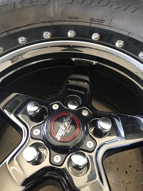

Bead locks will most definitely eliminate tire slippage on the wheels. FA4F86B7-BEAD-406C-87C2-C5B7A0B7AAA3.jpeg
Not the best pic. But my race stars are bead locked and had them widened from 9.5 to a 10 inch. I bought these off a forum member in here that had all the work done to the wheels before I bought them.

These are on a 315/50/17 the big boy tire. Lol

My research turned up the purpose of bead locks, at our 700-800hp power levels, is just to prevent from having to re-balance the tires when they spin around far enough to throw them off. Some guys have taped their weights to their wheels, in order to chase the tire and keep it balanced. I presume in order to do that, you would first have to have your wheels balanced with those weights stuck on "permanently"; while a 2nd set of weights would be movable, and aligned with the tire balance.
If your tire is only spinning about 1.5" per pass, how much would that translate into your 60' launch? I would guess not much. Whatever that number is, is that worth $x,xxx beadlock upgrade (since you already have wheels)?

My left side also puts down more rubber. I think your are correct with your theory of a little slip is better for the driveline.

Yeah I'm undecided although if I did buy some, the D5's are reasonably priced for beadlocks and I was considering buying matching fronts. But like you said though I already have wheels and it's not too much slip. I think the added slip reducing drivetrain shock isn't a bad thing either. The weight difference all depends on the wheel. My racestar recluse wheels are on the heavy side around 23-24lbs. A D5 non beadlock is 20lbs, and a D5 bead lock is 26lbs. Weld beadlocks are 24lbs (IIRC). I don't really care if they are off balance a bit, I only really use them for racing and hardly run them much on the street. If I see a good deal on some weld beadlocks I may pull the trigger, but like you said I already have wheels, so I don't think it's a huge priority to go beadlocks. I just may get front skinny wheels in the future and it would be nice if they matched, lol.

Yeah that's what I am thinking. I just wanted to make sure I wasn't thinking wrong or running an unsafe setup, but others have said that really isn't all that much slip per pass. My money is probably best spent elsewhere.

Bead locks will most definitely eliminate tire slippage on the wheels. View attachment 3178
So you are the lucky one that got those.👍

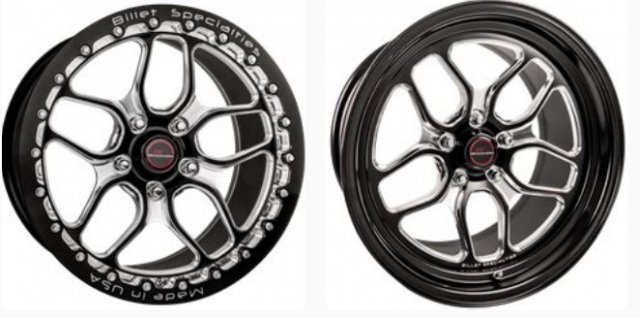

I had the Forgestar C5? setup, and I let it it rip. after 3 runs , It was noticeably unbalanced, I quit for the night, took the picture IMG_1251.jpeg
Then called up Mark Carlyle, who gave me a decent deal on these

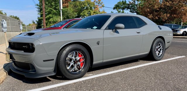

On the car

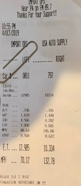

I just cut the best 60', and ran the best times I have ever run
