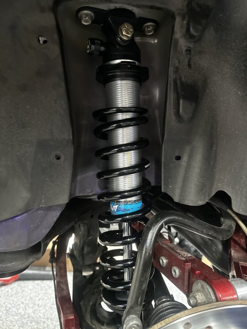

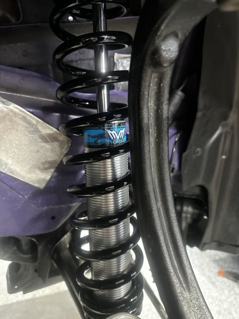

I like! All of the electronics are out of this car right? Wonder if I can disable the active suspension and switch to these
Yes shock delete engineering makes plug In adapters to keep light off
7,737
6,548
Ah no way really? Good to know. Let me know how these work after you dial them in
7,737
6,548
How much total weight did they shave off the car too? You remove the rear perch springs with these right?

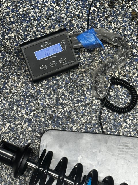

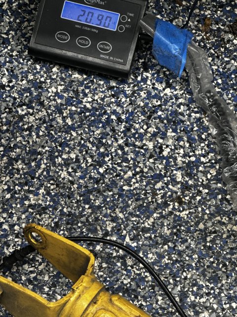

Was about 30 pounds total front and rear yes you loose the rear springs. Going to be a bit I’m putting in a cage also and my 3.8 whipple
