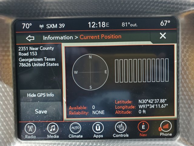

Hello,
As I was trying to assess why my UConnect clock was off, I discovered that the Nav/GPS location was messed up in my car. Here is what I have found:
- The car thinks I am roughly 27 miles from my real location. Mostly north, and slightly east of my actual location.
- I used the "Current Position" page (inside the navigation screen) to tell me the GPS coordinates that the car think's I am at. I then looked up the GPS coordinates of my current location using Google Maps. The difference was about +.319 degrees latitude and +.096 degrees longitude from reality.
- I confirmed that the map location that the car was showing me was equivalent to it's faulty GPS coordinates. So it does know how to link those still.
- I confirmed that as I drove down my street, the Current Position data was updating/changing. It was not frozen.
I took a picture of the Current Position screen (attached). I do not know what it should look like on a fully working UConnect system. But it appears the only data it could show me were the bad coordinates.
Are the 12 vertical bars supposed to be a "strength of signal" indicator?
What is supposed to be showing in the compass area?
What is "Available: 0"?
Reliability is NONE - Yeah, I got that :p

Looks like you have a bad gps antenna or connection. You have 0 available satellites, for a decent 3d gps lock you want 4+.

I might be able to answer a few of these:
Yes......the verticle bars are an indicator. They indicate how many satellites you are receiving a signal from. In your case there looks to be 0. This is confirmed by where it says "available: 0"
The compass should be showing you which direction you are facing. There used to be, and there still might be, a way to do a manual compass calibration. It used to involve going to a big parking lot and driving in a circle for a specified amount of time or turns (sorry, I don't remember all the details). The directions used to be in the owners manual or you can probably find them online. Based on what I found for a 2017 Charger, the compass settings procedure begins on page 245.
It's weird that you're not even showing at least 1 or 2 satellites received (you need 3 minimum for the triangulation). It's typical to have 3 or 4 be really strong, and have a few more with weaker signals.

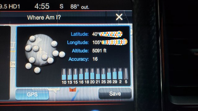

Different screen configuration due to different MY ('16)
16,663
52,169
I was sitting in my garage, so that's why I wiped the GPS coordinates, I don't want any of you stalkers coming after me...
:eek:
Good pic for the visual. That's what I would expect to see for a typical GPS signal display.
You're a good man Charlie Brown :LOL:

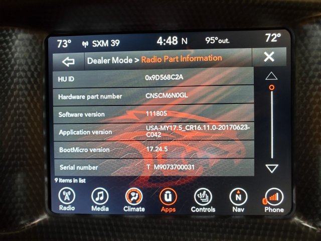

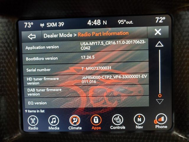

Thread Starter #20
I realize this version is older than what some are saying, but UConnect says it is the latest one for my 2017 Charger Hellcat.
Thanks
