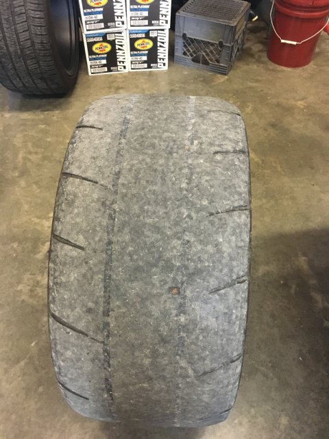

I seem to have more wear on the inner side of the tires.
Is this something that is an easy adjustment that I can do?
P-zero's seem to be doing it also but they are more difficult to measure

Not warranty in my opinion, unless there is something physically out of spec about stock rear suspension geometry. If you're getting on it and those DRs are non-stock sizes that change in size can cause changes in the way suspension plants them under WOT / max acceleration (and that can alter the wear pattern). If there are already suspension mods, that can of course effect it as well.

Bone stock. Not even a foot print gas pedal.
If it's squatting upon acceleration I can see how this is happening.
Mostly run sport and sometimes track mode.

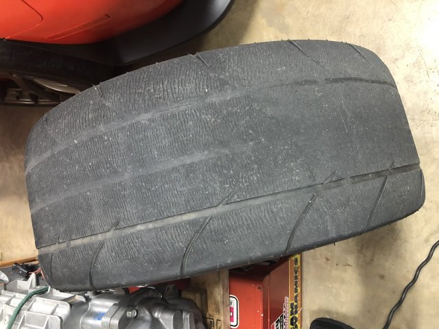

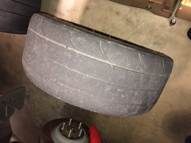

Mine wore exactly the same, it’s the way the DIRS is set up from the factory, it’s aligned for correct wear normal driving not 1/4 mile at a time lol
I bought BMR adjustable arms to correct it, it’s the only solution I was told
49118A34-96C8-47B0-AD6A-0DE9249F73CC.jpeg D549B03A-70EC-4164-95EB-77071BA68118.jpeg

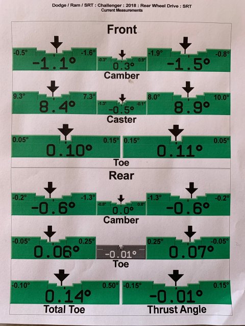

The stock rear suspension has negative camber . That will wear the inside of the tire.
Here is a pic of my last alignment.

@Hpindy I’ve been holding off installing the BMR parts I have looking for a good alignment targets, I can’t make out the numbers in picture you posted, you have anything clearer?

This was a "stock" alignment. I'm going for +.5 degrees of camber on ther rear with as close to zero toe I can get . Front will be stock for now .

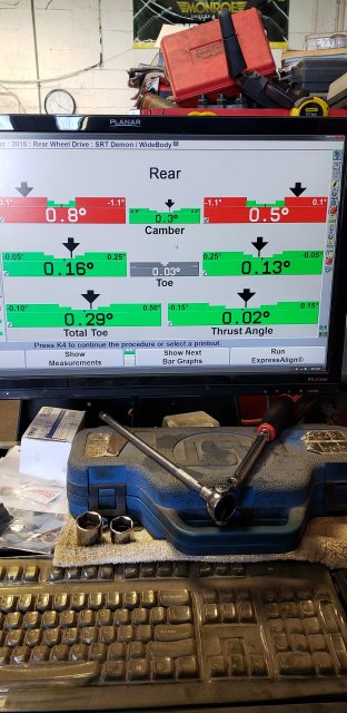

Here is a good drag setup for a challenger and charger,a little toe in in rear is good when car launches wheels will move foward and toe goes to 0,on a demon you want camber close to zero the rear shocks are almost locked and it does not squat much in drag mode.when a driver sits in this car its .5 on both sides.

This is the thread I got the picture from I posted a bit ago, Marc I’ve been looking for thread you first posted this in to confirm it was the numbers I was looking for, I knew eventually you’d come across a alignment thread and post again, THANK YOU!!
