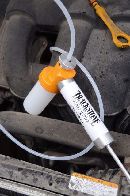

Well wouldn't you just know it, Blackstone Labs sells this:
Vacuum Pump
Which is fine, except it doesn't address a couple of things, and introduces a change to the way I've been sampling already, and I didn't want to introduce a variable to my analysis trends. (It doesn't accomplish the "clean catch" method and also potentially allows for sampling on a cold engine)

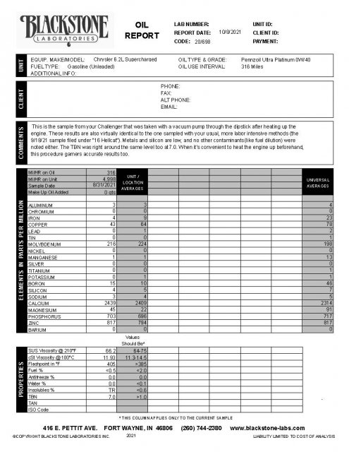

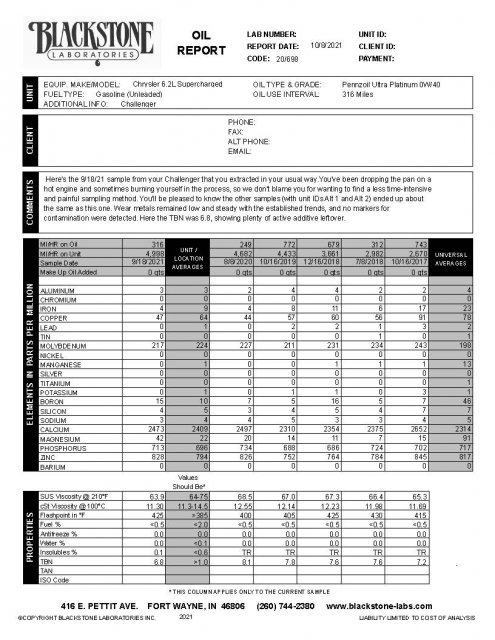

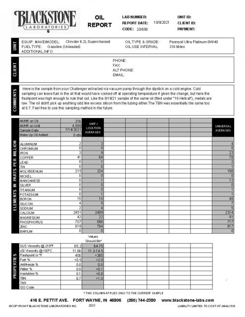

Well as apposed to debating differences in sampling techniques with either myself or anyone else for that matter, I set off to do what any good eeeginear would do, test...
"Normal" "clean catch" sample method from oil pan drain:
Vacuum Pump on a hot engine:
Vacuum Pump on a cold engine:
Ignore the statement about "dropping the pan", I don't do this, I'm not sure where this statement comes from. When they called me to ask what the hell I was doing, in my explanation, I think they misinterpreted my comparison of "oil pan PLUG" versus "dipstick".
So there are differences, that much is clear, but they don't seem to be notable?? I'll let you decide for yourself if you think they are or not.
