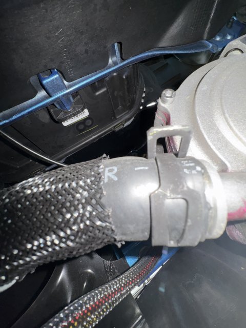

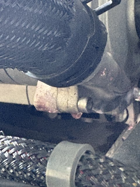

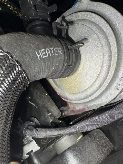

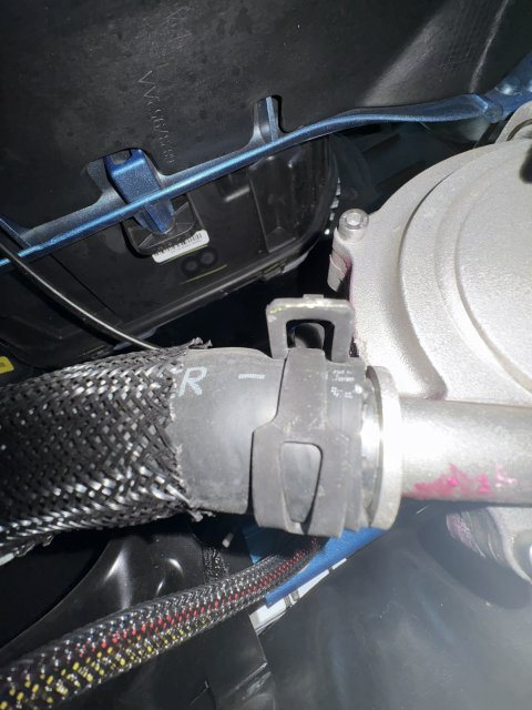

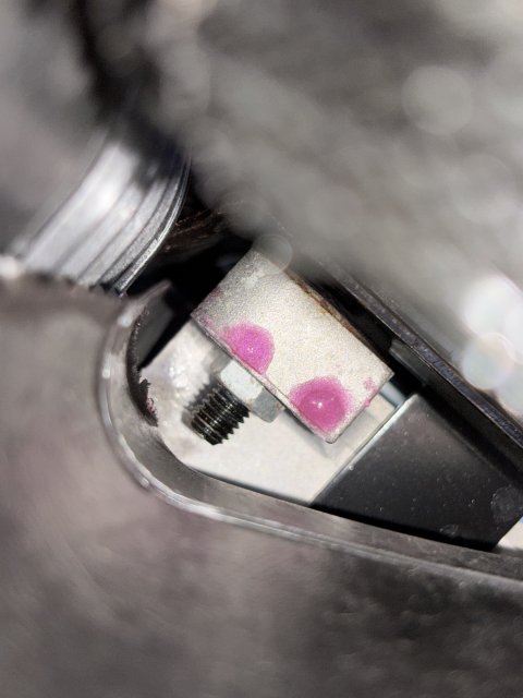

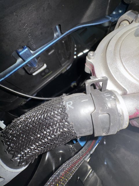

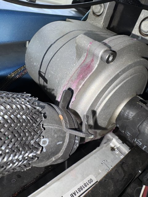

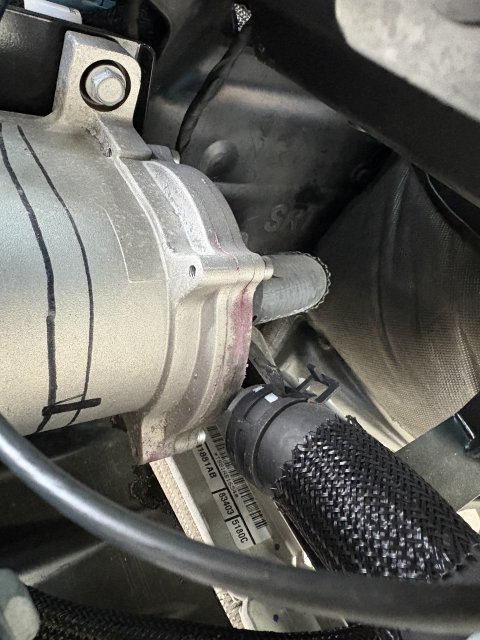

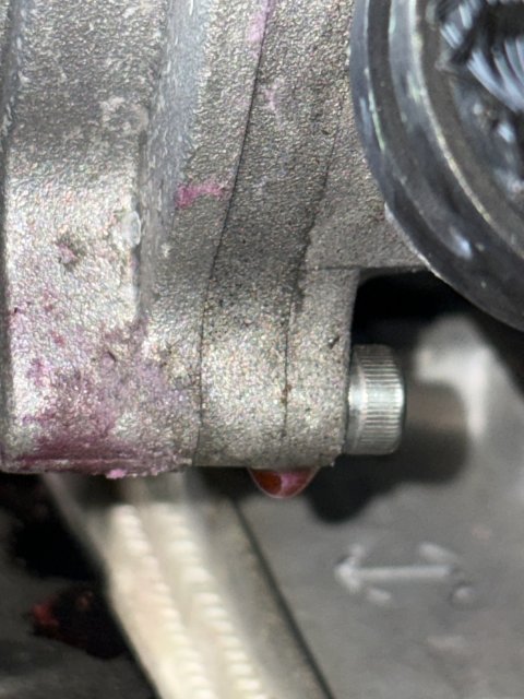

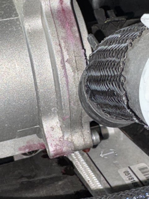

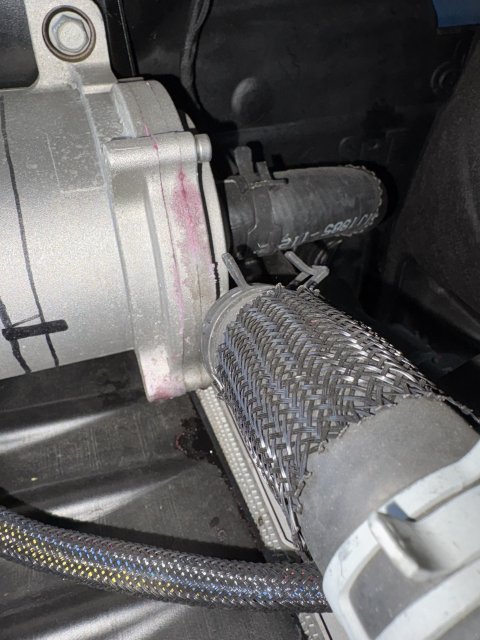

UPDATE!!! Do you guys think this is a supercharger coolant pump leak?
2,633
7,226
Seems to me. How shitty a job? Any direction where I should start would be a great help. Car is a ‘15 Challenger with 7.2k miles. 🤬. Thanks as always.

Subscribed (Sorry man, sucks...)

Thanks Bull, seemingly so. If it’s not just a hose or clamp. I understand pumps are hard to come by, and expensive. Got to do a search on R&R of the front clip as well as pump replacement options. Ugh…

Start with the easy-to-fix solutions, like re-torquing bolts. Then spray it all down with soap, rinse and watch carefully. Maybe a hose is dried out and lost its seal. Be patient, a few drops lost is no big deal. Take your time and isolate the leak.
Years ago my Wrangler TJ was dripping oil from the rear top, maybe a valve cover gasket. Luckily I first retorqued all the valve cover bolts, and several were loose. After tightening the prob disappeared!

Will do. Thanks 2A. Before I do anything I’ve got to get eyes on it, which I guess is going to be the biggest pita.

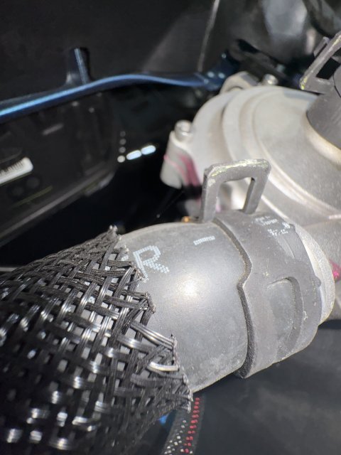

I think I’d start by moving that clamp off the hose and putting a worm clamp in its place good and tight.

Do the easiest thing first!

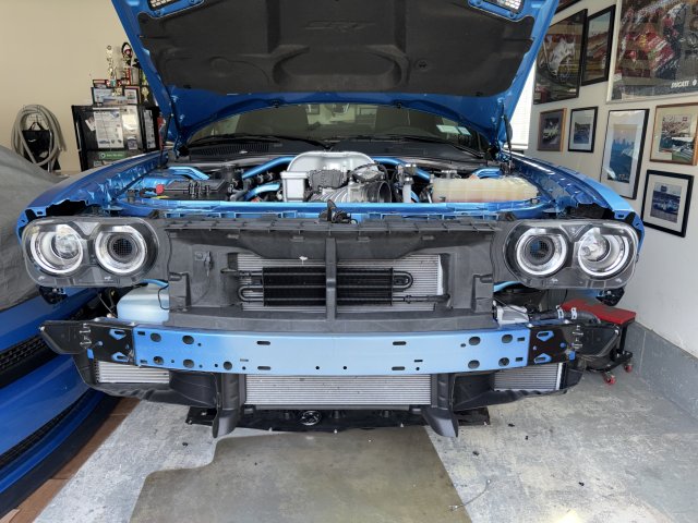

Just looking at a few YT vids front facia r&r doesn’t seem too involved. I’ll start playing with this tomorrow. I’m going to see if my local auto part stores have a pressure tester available. I guess the pressure tester will go onto the reservoir on the p/s shock tower? More to come.

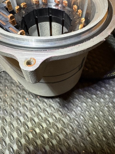

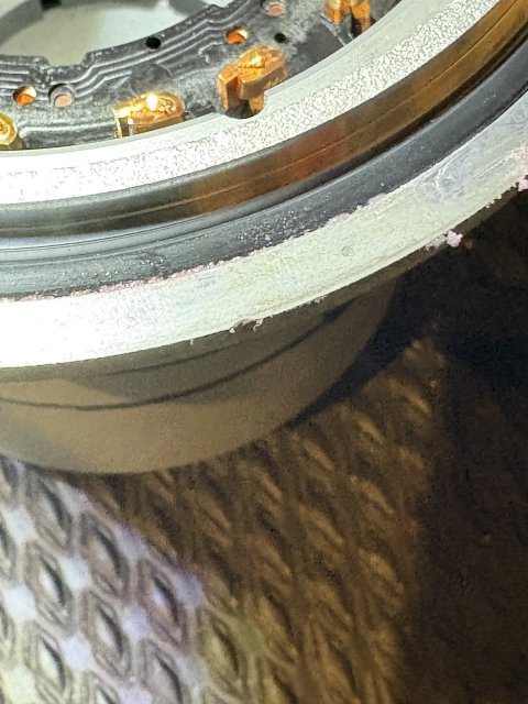

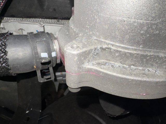

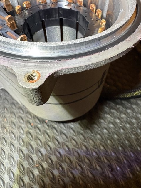

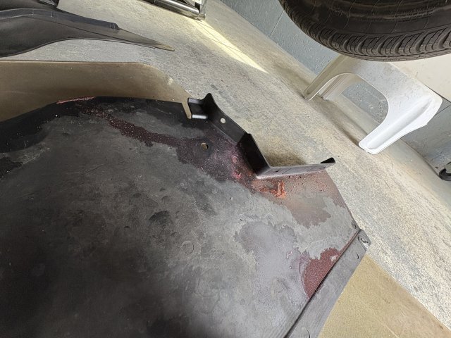

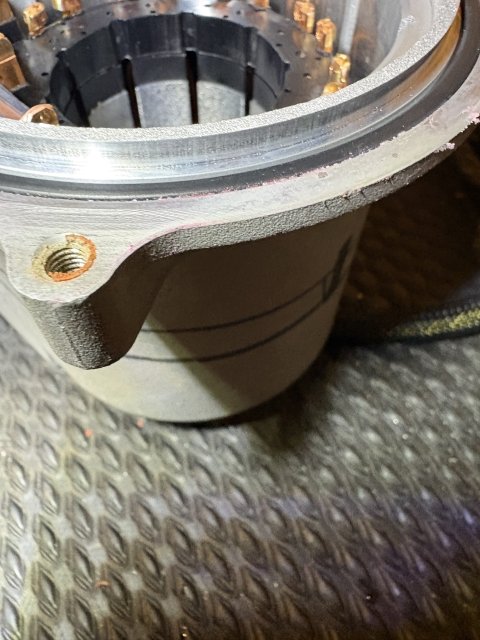

Latest. Front end off, easier than I thought, relief. Intercooler pump has 2 half’s with seepage. I tried torquing down the bolts holding it together. They didn’t move. Anybody deal with this???

There doesn’t appear to have a gasket between the 1/2’s. Wtf?
