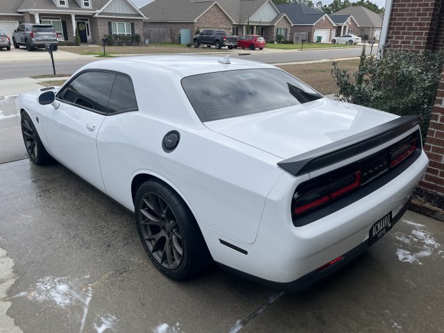

I have a narrow body challenger, but have Phillips performance fender flares and have a 11.5 wheel with 335 30's on the rear.

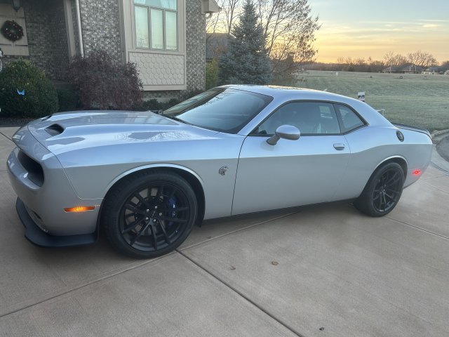

Welcome! Here’s 10.5 rims with 305 nittos on back and 9.5s with 275s on front.

Wheels are Triumph SVS 11.5 x 20 in rear and 10 x 20 in front.

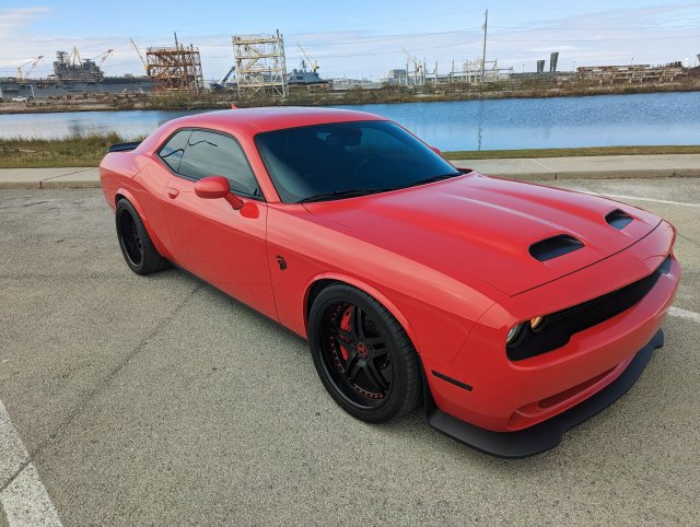

This is where I ended up, 305/35 Michelins for the street on 10.5 in replicas and then a drag wheel/tire set up when I'm feeling frisky or hitting the test n tune.

Yeah it’s mostly tucked in the wheel well, but at the same time I had minimal rubbing of the plastic inner liner so I had to trim it a little and heat a couple spots to re-form. So I have the PS4 summer tires, they still spin pretty easy if I want them to but it’s so much more capable than the stock joke 275s. Car shifts so much cleaner with better tires. My drag wheel/tire is cheap, Bravado 18s with ET street R 305/45r18 and they work really well! Very happy with how the car performs. Now on those 10.5s if you want to just use a street drag radial 305/35r20 there’s the Nitto 555r2 or Mickey ET street s/s, I couldn’t say which is better. I have run et street s/s on other cars and they work well, I also had a set of 555r Nittos a while back and didn’t like them nearly as much, they seemed barely better than a good regular street tire.
