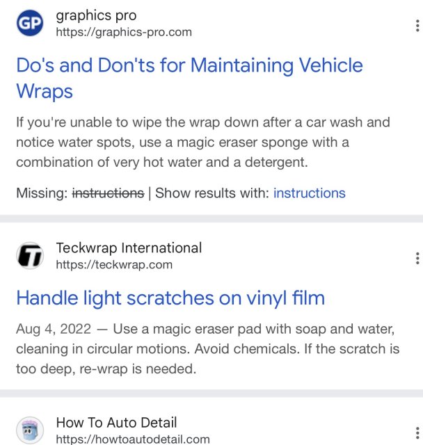

I did some searching on the magic Erasers.
🤣 Oh boy, Magic Erasers are like the wild card of cleaning tools—miraculous on grime, but savage on finishes. Some of the “don’t even think about it” warnings people share are downright hilarious (and a little terrifying).
Here's some good advice for you guys :ROFLMAO::ROFLMAO::ROFLMAO::ROFLMAO::ROFLMAO::ROFLMAO::ROFLMAO:
"Don't clean your genitals with it ever! Unless you're trying to do selfie gender reassignment. Even then, I'd advise going to a licensed doctor who has a little experience in that field."

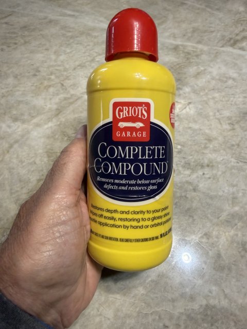

Simple and the accepted proper way. I do not know shit about anything called “magic”. Forget-about-it.
Clay it. That WILL remove the water spots. Then you need to treat it and protect it.
After the clay use this.
Then it does not matter but at your choice then apply a wax or protection layer of your choice. Regular, ceramic, whatever but get a coat of protection on it.
Whatever you do to the water at home quit using whatever spotted it. That can be minimized by wiping the car off quickly and completely after a wash, period, no exceptions to that rule no matter what water you use.

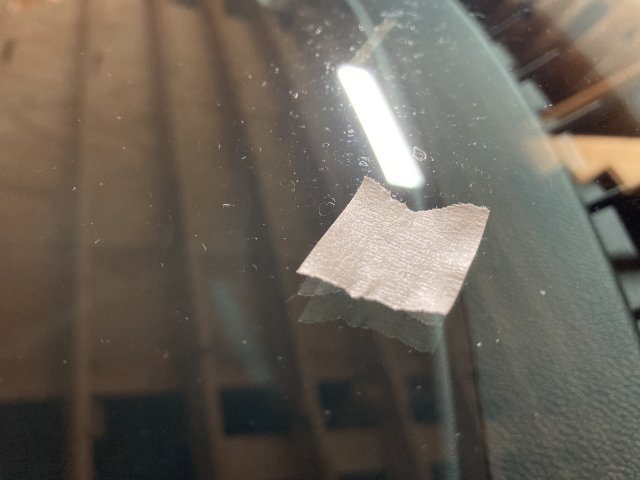

I have tiny water spots over the entire surface of the car, paint and glass. Washing and waxing does not remove them. I thought they may be calcium and tried vinegar but it does nothing. There is Chemical Guys Water Spot Remover but reviews say it sometimes makes things worse.
My well water is acidic and I add soda ash (sodium carbonate) to neutralize the acidity. I stopped using it a while back and suddenly I had copper pipes leaking. I ended up replacing a bunch of the copper with Pex. I continue to use the soda ash.
I worried the spots might be acid etching the surface but if I scrape the glass with a razor it all comes off meaning it is build-up on the surface and not etching.
So there are 2.5 problems:
1a: How to remove the spots without abrasives? Maybe clay? 1b: Does it hurt to just ignore them?
2: How do I prevent them in the future? Articles say wax, but I have been doing that. And they say ceramic doesn’t help stop it. And I'm not about to spend big $ to filter water for car washes! Remember, I'm cheap!
I would appreciate suggestions from those who have experienced this.
Thanks.
