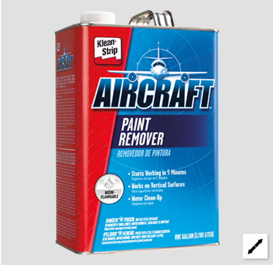

I use this stuff. Works great! The trick is to get your parts tightly covered in plastic wrap ASAP after application to keep the chemicals from evaporating too fast. Let it sit 15-20 minutes then paint just wipes away. It is also great for finding small unknown holes in your gloves as it will burn like hell on your skin.

45-70, thanks for the plastic wrap tip. I’ll try that. Can’t see how the stripper wouldn’t tear through plastic wrap in seconds!
