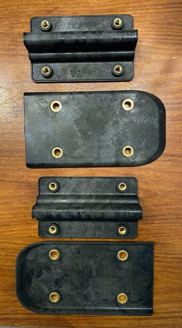

I just bought a 2019 challenger redeye. I found these parts in the trunk.
mopar says it's "Air Deflector Plate - Mopar (68419118AC)" something about a wide body mine is a narrow body... is it trash????

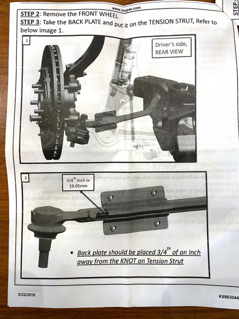

Those are for your front brakes.
Piening2150
#1025
787
1,751
Toledo
2017 Charger Daytona 392
Like Bull said, deflects air towards your front brakes for better cooling. Works fine on narrow bodies too. Do you really need it? Not really, but it definitely doesn't hurt.
