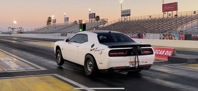

I seem to be stuck in the 1.5x 60' range. Car ran 9.83 at 140 in -600 DA and 10.059 at 140 in 4300 DA. Both runs different tracks different days had 1.52 60'. Stock suspension and 2.62 gears. Reminder I'm on a 2.72 litens pulley, RE motor, injectors, and tune. Car didn't spin on either run, but if I put more power down low it blows the MT 305/45 17 ET Rs off.
I'm looking for low 1.4s 60'. Mike gave me a tune tweak recently that I think helped in the higher DA runs, so maybe the 60' will be better on cold temps, but I'm thinking of some suspension changes to help.
I drive the car on the street, A LOT and do not want to give up any street handling or end up with a wallowy mushy ride.
I'm not a suspension expert, so what should I be looking at? If component changes I'd be looking at AAD stuff.

I highly recommend the AAD "wheel hop eliminator kit" and the BMR cradle lock out kit . ( you already have the DIRS) . They are a great first step in reducing your 60's . Have the rear camber set to .5 + degrees and all other specs stock .
I have the demon springs and sway bars front and rear which helped too . My ride is still "tighter" then a demon . I have zero issues stopping and cornering in my car . I also have 2.62 gears and the same tire as you . But once they are done I'm stepping up to the 315's .

I was able to get into the mid to low 1.40’s with a set of 17” wheels and the 315/50/17 MT
I have mopar rear springs, BMR cradle lockout, BMR control arms, and (can’t remember exactly right now) some other bushings done in poly in the rear as well.
I’m back on the 2.62 after playing around with 3.09 and back.
I went to adjustable control arms from the fixed I had on previously, and had the car aligned with the wheel combo I was racing with, that way I was getting the best contact patch. thats very important.

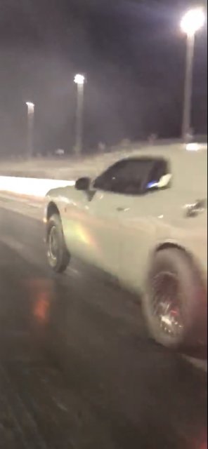

Some of my thoughts... I prefer to use the more gear/more tire combination. By “more” I mean taller. You don’t want a taller tire with the 2.62. It’s too much. So you’re sacrificing that additional traction you can get with more tire due to that 2.62 gear ratio. I know some get better results with the 2.62, but those are super high hp cars that can pull that higher gear. Even they are using the 28” tall tire because the 30” is harder on the driveline with the 2.62. Speedy.... your car is not in the high hp category by comparison. I think you would benefit from the 3.09 with the 315/50-17. With my pulleyed stock motor (9.50@145) I was running low 1.40 sixtys with that tire/gear combination. If you don’t want to go that route yet..... the single biggest thing is alignment to get what you’ve got square and flat on the track coming off the line. To do that you HAVE to have adjustable control arms with stable bushings. Whether you can go with the top of the line (expensive) AAD Drag Set or something else (Spohn, BMR or whatever)... you need that zero toe/zero camber setting when the car transfers weight off the line. I think springs help with the initial weight transfer but I think alignment is more important. You can’t hook up if you’re only using part of your tire.

You’re right. They don’t squat much. Maybe one inch max. After observing this.... I reduced my positive camber to a .3 degree setting. It just doesn’t change as much as I previously thought. I would suggest anybody that also drives on the street or doesn’t leave that hard just go with a zero toe/zero camber and be done with it. This is what a 1.3 sixty looks like and the fender doesn’t even come close to being on the tire. 40DDFA35-83A2-4C38-9E61-07A2FF155DFF.jpeg
