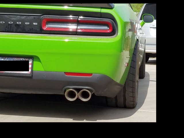

I agree, those flares are nice. Not inexpensive though. Wish they made some for the Charger. My 315s with 3mm spacer are barely, mostly, kinda not sticking out...maybe a little.

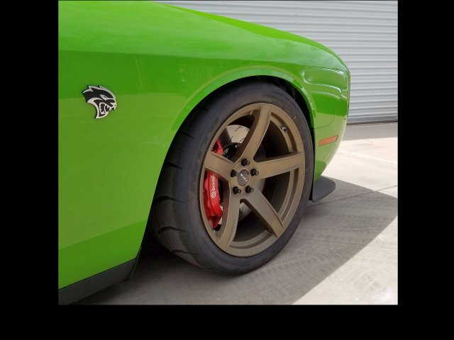

I am currently using the Bronze HR5 wheels from PK Auto Design. Rear wheel is a 20X11 with a 315 Nitto NT-05.
Front is a stock size 20X9.5 with Nitto 285 NT-01's. No rubbing anywhere, and the car is lowered with the KW setup.
Same wheels are available in black.
I also installed the longest Doorman wheelstuds available combined with open end Monster lug nuts.
