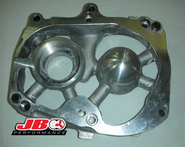

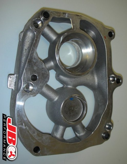

What is blending of the spiders ??
3,662
8,603
And remember, it making noise is one thing, it getting REALLY unhappy in a flash at 25 k spitting shrapnel into you engine turning 6500+ is another, you’d, we’d wish we spent the 2-3k on a experienced blower rebuild then wouldn’t we??
3,662
8,603
This, The legs that support the bearing housings, look like legs from a spider, to me at least lol 4FBC3D9F-1084-4767-93D7-860C8609FD52.jpeg
3,662
8,603

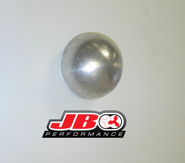

This smoothing blending and air-foiling of the obstructions in the air path let’s the blower breath more which means more boost without spinning it any faster, good for 3040 hp I’ve heard. I want to do that to my blower, even just adding the cone cover over the flat bearing plug is good for some boost
3,662
8,603
Stock bearing cover plug looks like this, they sell this cap to help blend air flow over it
