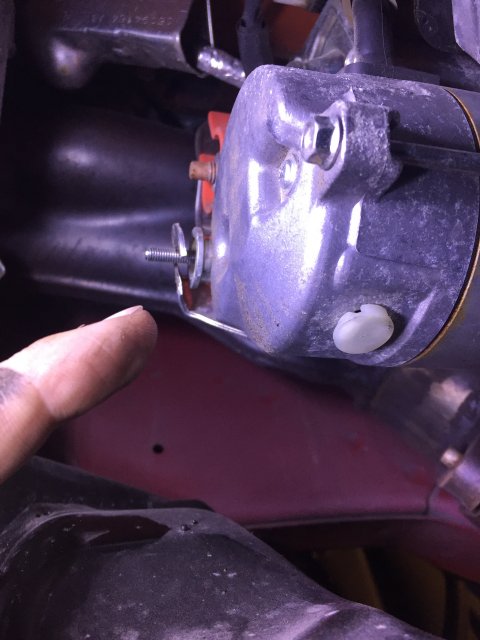

After pinning my crank I was cleaning up the under carriage before putting the belly pans on. I looked over by the starter and noticed that there was an M5 nut missing on a stud that has the heat shield connected to it. I have a feeling when my cat’s were replaced ,during the recall, they had removed the starter and forgot to put the nut on. My question is; was there anything else supposed to be under the nut when I replace it. Of course I dont have an M5 nut laying around. Ordered an assorted kit of metric nuts.
It almost looks like the negative post but I see no cable....its an awful long stud if its only for the heat shield. 7B925B08-8B41-405A-94CA-4C647A412DC5.jpeg

I believe that issue has been mentioned here before. Some add one, others don’t.

Looks like a M5 metric nut
It almost looks like the negative post but I see no cable....its an awful long stud if its only for the heat shield. View attachment 36781
To replace the cats, the starter is not removed, there is no nut put on the stud for the heat shield, but it won't hurt to have one.

Thread Starter #17
Thanks Mean Cat, I think I will.
