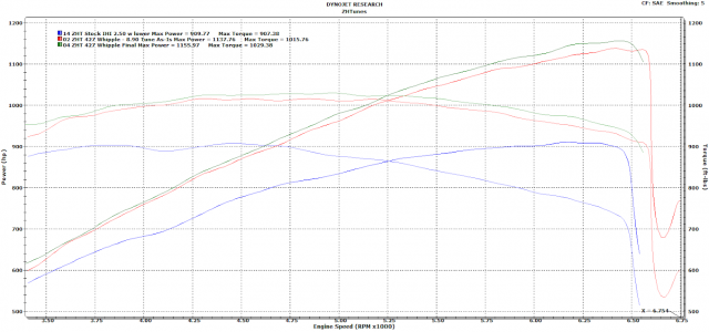

I've had my stroked Whipple for almost 4 months now and I couldn't be happier with it. However, my perspective is a bit unique given that I'm tuning it myself while also doing as much of the mechanical work as I can in my own garage. The journey of working through and figuring out all the issues is part of the fun for me. It's still a work in progress today.
My full build list is listed on my dyno and 8.90 videos so check it out there.
Here are my best 3 time slips so far in 2400 DA.
And here's my dyno graph comparing my previous stock block IHI 2.50 + lower pulley setup vs the built stroker with a Whipple.

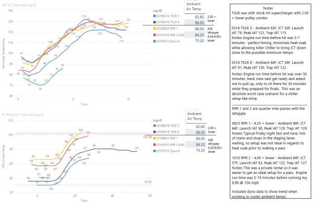

For WOT performance on a track.... you need a supplemental cooling system. I’ve run both 1/4 and 1/2 mile at WOT now without IAT going over the 150 degree line.
Totally agree, supplemental cooling is a must though that also applies to aggressive pulley combo's like what I had before I did the swap.
For comparison, here are my IAT's and ICT's before with my old stock SC 2.50+lower configuration versus now with the Whipple.
Dam that sounds mean... 👍
Ice box is going in same time with the whipple.
FI chiller system will be next.
Thanks for posting up the info. Good stuff right there.
All I have is a 1.25 gallon tank and Killer Chiller. I was going to enhance my setup with a trunk tank with more capacity or a 2nd Killer Chiller core but since what I have is working for me, I'm going to leave well enough alone.
3,343
6,674
@zhc - am I reading those graphs properly? Not sure I can extrapolate that if the ambient was the same for both blowers that the delta would get better or worse... Over time it looks like the IHI actually reaches some sort of equilibrium whereas the Whipple just keeps getting hotter.
If not excessive heat with the IHI, why go with the Whipple at all? I thought I read that the single largest limiting factor forcing people to go to bigger blowers was the very high temps when the blower is overspun. I don't think I'm seeing that in the data - at all. Is that possible?
