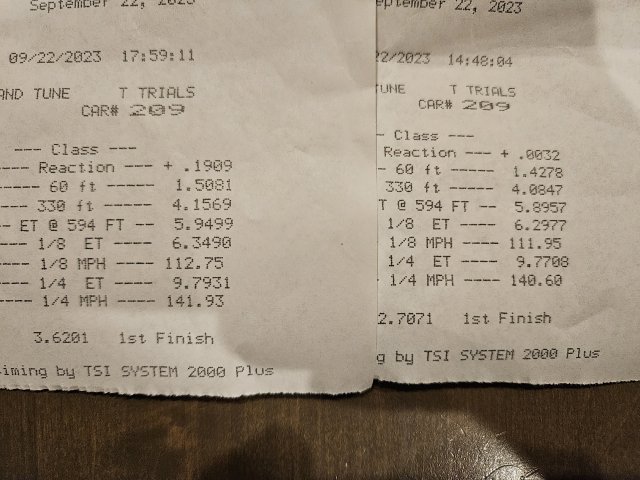

When I first heard about the DC stage kits for our Redeyes I was sure I was going to go that route, I'm happy I changed my mind and had @Jon-MooredPerformanceLLC do the tuning on my car, Jon is a great guy to work with.
This is only my second time out after his tuning, first time with decent prep, I'm sure it will go quicker with a little more seat time.
My car is 2019 Redeye with 2.62 gears. Mods are as follows: 3.1 upper pulley, SDG snout, 108mm throttle body, JLT cold air intake, FIC 1200 injectors, Jon's e85 pcm tune and TCM tune. The car also has the usual AAD rear suspension bits, P4D diff brace, and 305/45R17 ET street R tires. Temperature was around 74 degrees, DA was +2000.

I would try the 315/50 or 55 that they now have available.
I have considered making the switch, but I'm going to use the 305's a bit longer before making a change. The car does hook good with them when the track is prepped well, I'm fairly confident I will be able to get the 60 ft times into the high 1.30's as it sits.
What I didn't mention is that the 2 slips posted above are with two different tunes; the 1.50 60 ft is with a soft launch tune, and the 1.42 was done with the tune that hits harder out of the hole. I didn't know how well the track was prepped so I wasn't aggressive on the launch when I got the 1.42, this time should drop as I get more seat time.

DAMN IMPRESSIVE CONSIDERING THE MODS IN GOOD WETHER IT WILL COME ALIVE
