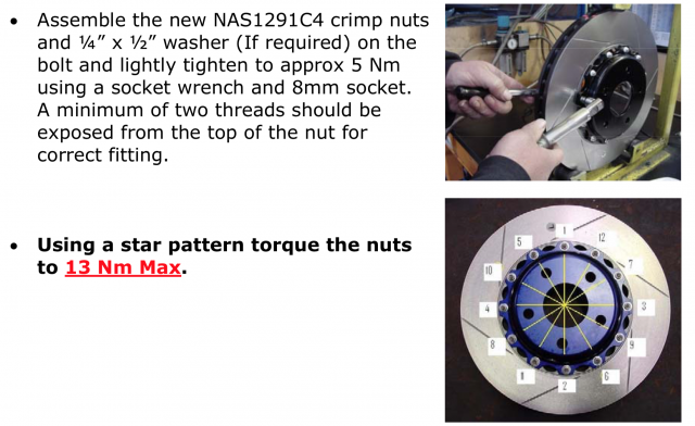

Retorque the rotor ring nuts on all the rotors to 78 In.Lbs. This has fixed the issue for several here, but should be checked to eliminate.
13 Nm = 115 inch lbs = 9.5 ft. lbs.
I would clean the hubs where wheel contact is and rotate the tires before doing this though. Nuts are on with thread lock which will be broken if re-torquing only.
This is definitely I think my issue.
